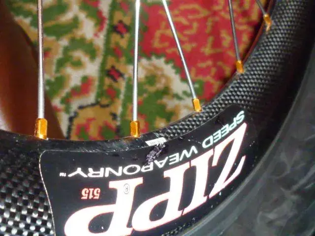

Here we go cyfa me lad :wink: home made truing stand.....and one wheel finished 8)
Took me about 1 hour because of the deep section carbon rims,if you have alloy double walls should be a lot quicker :wink:

One thing I know about steel and aluminium, is that they together will seize. I found this out when I had to make an allumium clamping sleeve to protect the thread on a bolt. I knew they might seize and they did, after only two weeks in indoor conditionds.
Beer is friendly !
Strange as seatpost bolts and skewers etc,all use steel into aluminium and dont sieze....not in my experience anyway....
A nipple is a lot smaller and easier to round off than a seatpost bolt MM. If they were bigger you'd be able to unseize them without rendering them usesless.
When you've had to explain to as many irritated customers as me, (and put up with their reaction) that the only way we can straighten their wheel properly is by cutting half the spokes out then more of you would think the way I do.
Of course - these have been bikes that have been out there getting hammered, whatever the weather. If people are just building a bike to put on the wall or pootle on in the summer, then it's less of an issue.
Fair enough,but mine dont even get wet let alone hammered :oops: :lol:
Occasionally muddy but that is it :lol: So I am not to worried.
But alloy nipples if prepared well in the building should not seize, in preparation I am meaning the lubrication of the nipple with anti seizure grease, which for me is a requisite due to what I know about the likelihood of aluminium alloys seizing when in contact with steel.
Also I am understand the use of the correct tools for the job greatly reduces the possibility of the spoke key rounding off the nipple, to which I understand the unior spoke wrench is pretty good at avoiding due to it working on three faces and three corners of the nipple;
http://www.uniortools.com/product/spoke-wrench-1630-2p
As to spoke length, I also understand it is more crucial when using alloy nipples, as the threaded spoke taking up all of threaded nipple actually reinforces the alloy.
