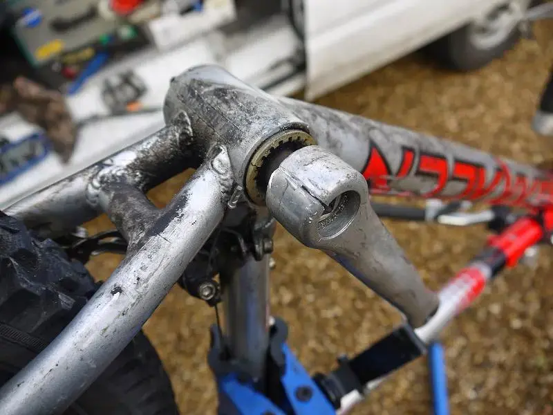

If you've decided that you're going to scrap these cranks then it won't hurt to run a hacksaw down it like in the photo I've just googled below. Watch you don't catch the frame and bear in mind that your crank is steel so it'll be fairly tough. It may help to open the cut up by knocking a chisel in.
Nice method...............
If the bike has a sealed bottom bracket (I doubt that it has if it's still original) then you can get a stuck left arm off by putting an open ended spanner behind the offending crank and undoing the bottom bracket on the drive side.

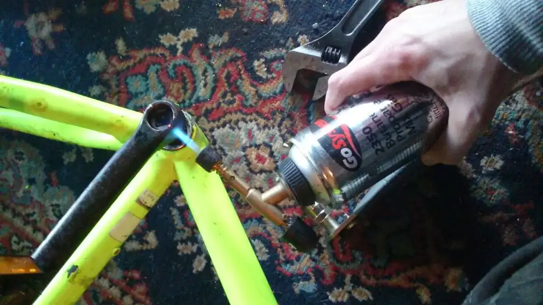

I tried the hacksaw methof for about 20 seconds and thought "fcuk this"..
I got hte blow tourch out and heated it up for a few minutes and a simple tap with a hammer and it came flying off. Amazing :P
I'd been hacking at it for ages today and last night. Amazing what a bit of heat can do.

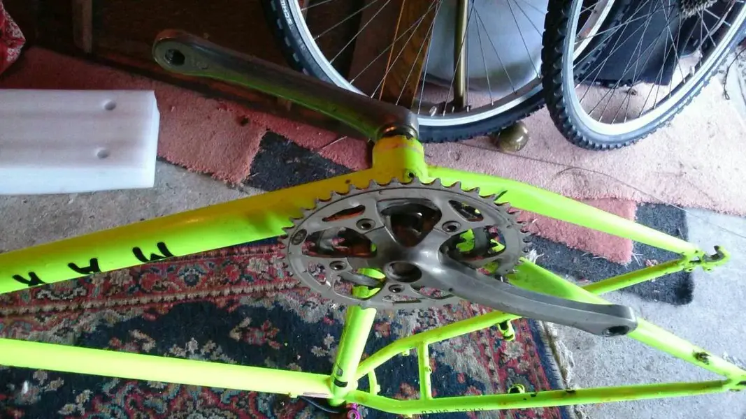

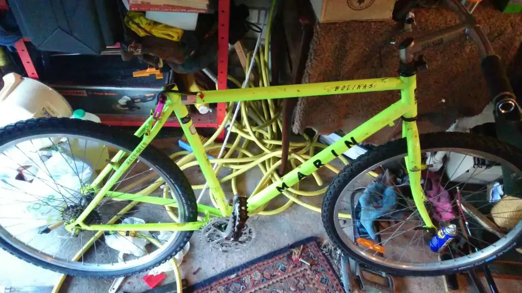

I've got the crank that shed said me on to it now and it's starting to look like a bike again.
I've cut myself 3 times and i've got a tiny metal splinter stuck in my finer.. oh and i burnt myself :| :facepalm:
The headset/forks are rattling and are kinda loose.. gonna watch a few youtube vids on how to fix that.
