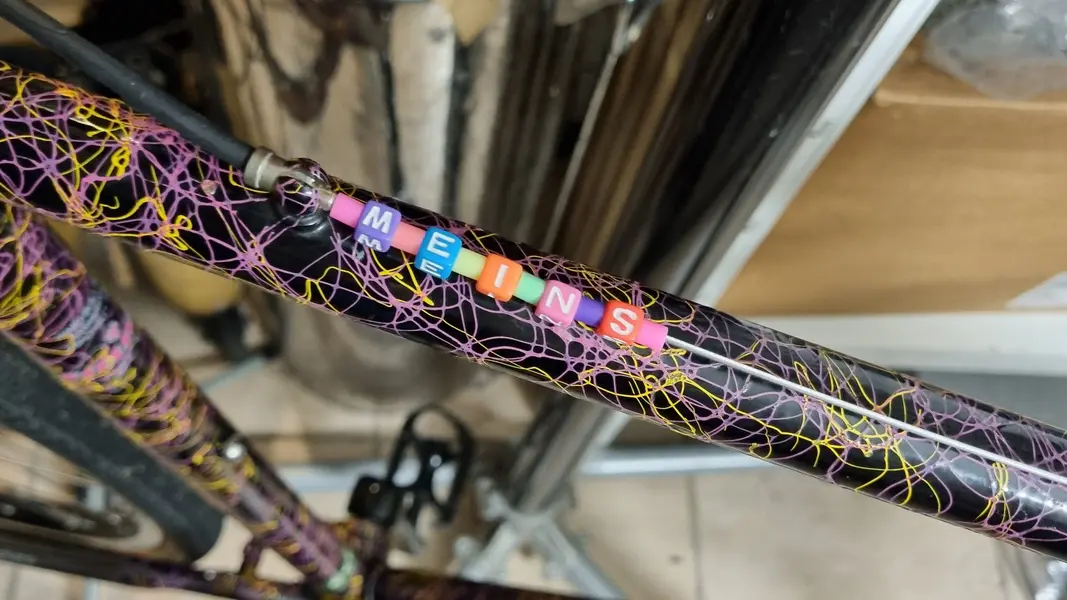

Suggestions to stop brake cable ping (not zip ties)

A more serious advice would be to check brakes and cable routing in general if there is any chance to improve the tension?
Just from your picture it looks to me that there is very little tension or something isn't right, as this doesn't look tight at all.
Maybe you shouldn't use a closed or complete outer tube, but have cable stops on both sides of the top tube and use a tight cable in between just protected with an inner tube liner?
