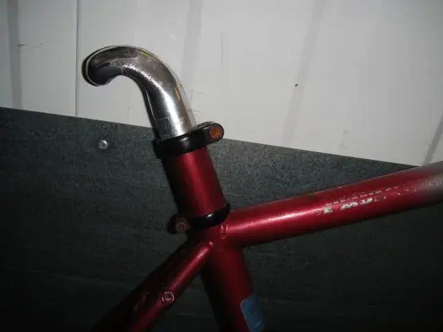

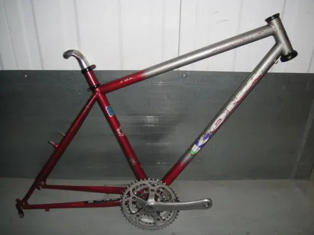

I've stripped it as much as I can and took a couple of pictures. As you can see it's in very deep.
I don't have the right tools to remove the crank or bottom bracket so have squirted WD40 in the bottle cage holes to get in side the frame.
Popping over to a garage tomorrow to use their vice.

You may be lucky if someone shortened seatpost.
Just loose that seatpost binder. Or am I binder :twisted:
Sorry for telling obvious. Good luck!
WD40 wont do anything. You need proper penetrating oil in there.
Leave it soaking for a few days, then use mole grips or a vice and twist and it should give up. I've had seatposts stuck with less showing than that and worked them out this way.
