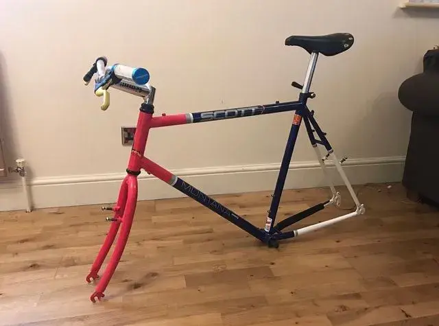

Just purchased a 1992 Scott Montana with hope to get into proper cycling again after years of bmx..
Have collected an array of parts for the bike already (just waiting for them to arrive) however struggling to find a FD/RD to suit. Have a 3x7spd set up already.. My question is will any Shimano FD/RD work as long as they are 3x7spd - as i've seen some posts giving a limit on 'pull' for the FD. Front Triple is a 46/36/24T.

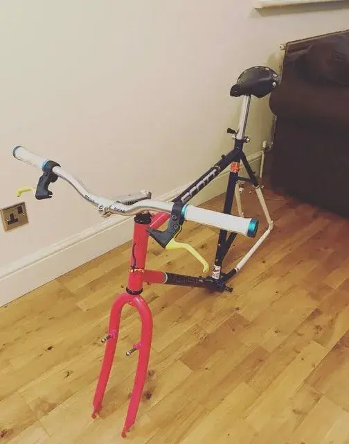

Here it is looking rather sorry for itself at the moment whilst I wait for parts to arrive! (ignore the yellow brakes & white grips!!)
Any help/advice is appreciated!

howdy - and welcome.
the front derailleur will have to have the correct band diameter (the mounting bracket part) ... and, it will need to have the correct pull/activation configuration to suit your bike's cable routing arrangement (either top or bottom pull).
Welcome to the forum!
Looks nice to me, look forward to seeing it take shape. You'll need a front mech with a 26.8mm band, and a bottom pull one, as the gear cables go down the downtube. As for rear mech, anything goes really. They will all work with 7 speed, if you have 7 speed shifters. With the exception or Sram ESP.
Hope this helps
Mike

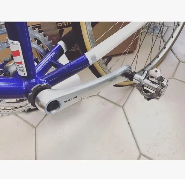

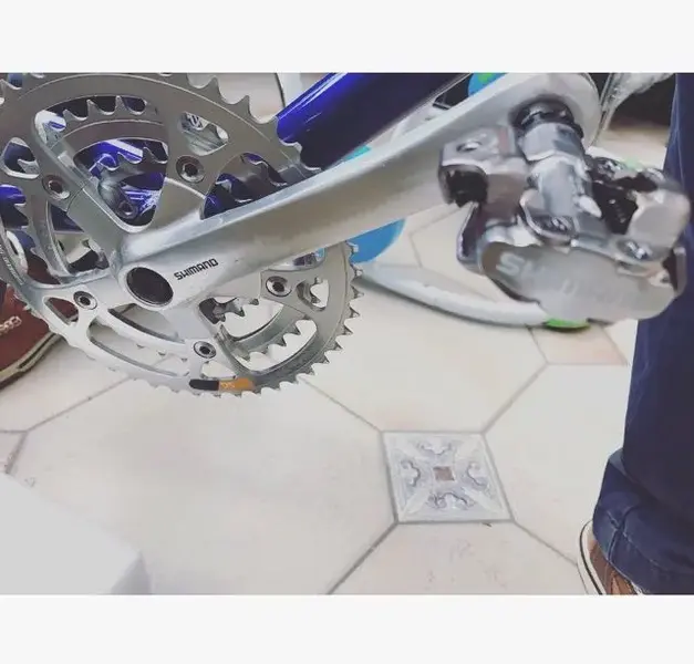

Updates - Cranks/Pedals are now on .... & a little preview of the hubs... test fitted the wheels but waiting for some new tyres to arrive!

Shiny stuff... looks good.
Welcome to the forum.
al.
It depends on which type of shifters you like really. For trigger type, then Lx or Xt would suit, to go with the brake levers. Thumbies are a good option, Deore ones are cheap and are easy to set up. Or Gripshift type. X-Ray or Sachs wavey both work with Shimano mechs.
Looks like it's coming together nicely!
