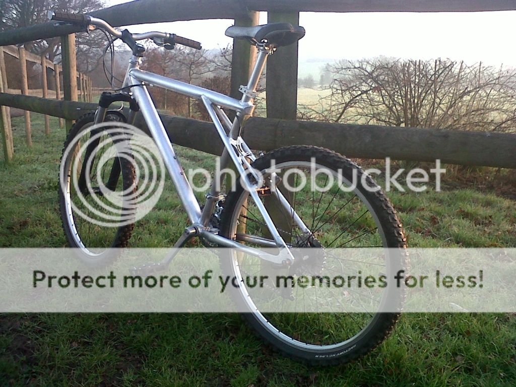

It's all done!
Pictures taken on my commute to work, I get to ride cross country.
I would be interested to hear people's opinions on the frame, as the brushed effect is a bit different to the usual polished finish that looks so nice on these GT frames.
The only thing I might change is the saddle, had a period Tioga to match the tyres but it was very uncomfortable, so have reverted to an old faithful saddle that does not look up to much but provides the required levels of comfort!
Thanks to everyone who helped on this project, supplying parts etc, and thanks to Mikee for his initial inspiration!
