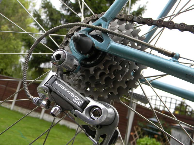

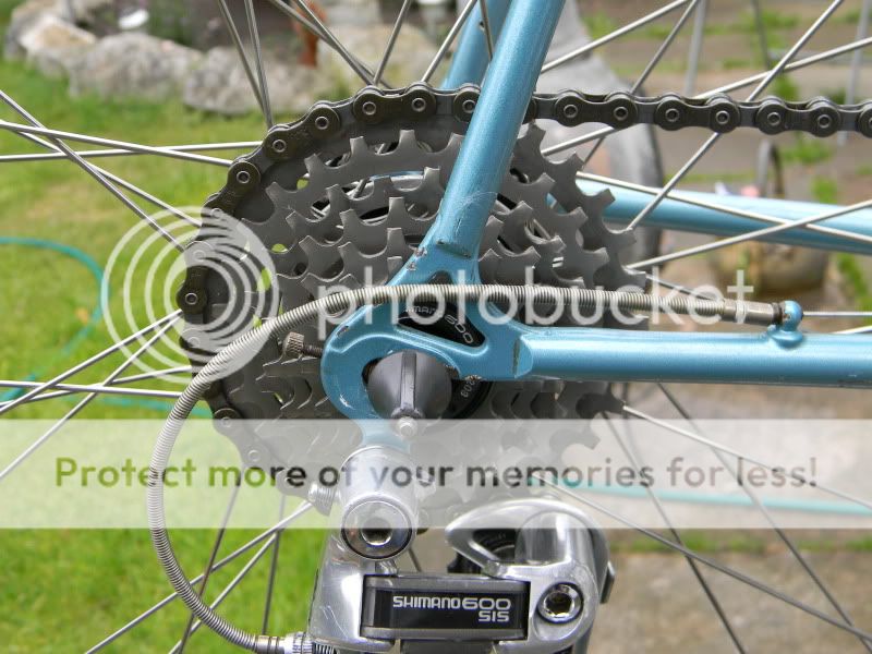

i live i a fairly hilly area and the short ratio 600 freewheel that was on there was just to.. well short! lol.
anyways i happened across a wider ratio 600 freewheel :)... same model and 6 speed as the original but with 13-30 teeth :).. also NOS in the box!!
anyways it arrived today so on it went!!
all set up and indexeing like a dream!
that was this months budget blown!!.

Hey Zotty, how does the rear mech get on with that wide ratio cluster? I only ask because I have a feeling I may need one when I get my bikle finished, I have the same 600 mech, I'm sure they're o.k up 28t? o.k if you don't run the 30t on a 52t chainwheel? (like anyone would)
yeah 28t is max and thats what i'm now on ;).. realised my local hills just aint that steep!!
as for the cables... clarks outers all round :).. the inners are the original shimnos dad fitted back in 86 :)
