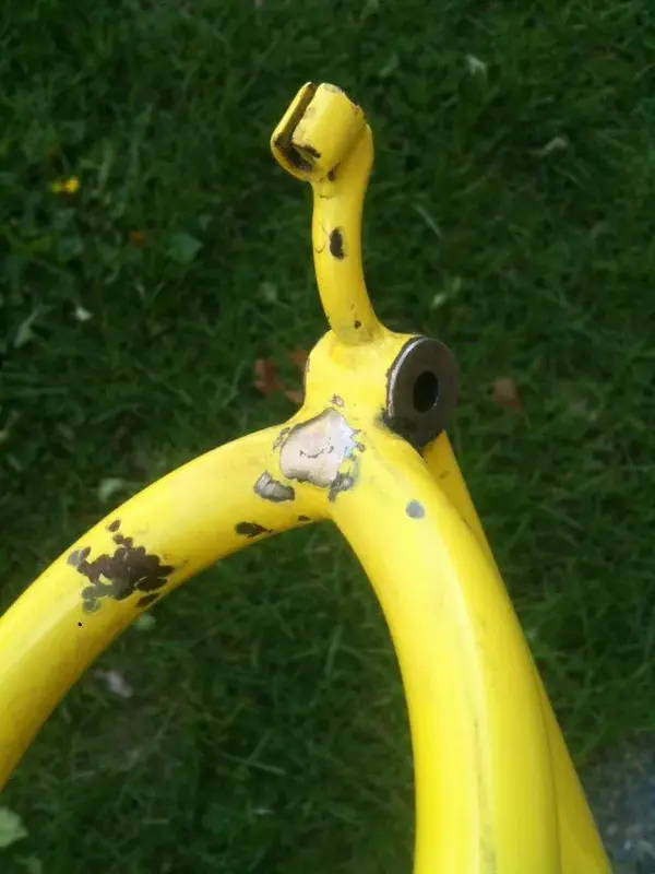

Received a call from my framesmith yesterday, it's repaired and waiting for me to pick it up!!
Seat Tube repair
Picked up the frame today, looks like a nice repair!
I also spent a little time and removed the fender mount from the rear sub-frame. Still needs a little smoothing over but bike is progressing.

Re: Mr.T's Defiant
okay, need to ask. how is that seat tube structurally safe without a seat post inserted within past the top tube??? :?
Re: Mr.T's Defiant
I have no idea how it could be strong enough.
Maybe the rear suspension takes some of the impact that would normally be directed in this area? In any case it seems to work.
Re: Mr.T's Defiant
Well it looks a nice tidy repair and yes i do believe the rear shock helps take some of the stress away the seat tube hence the name Shock Absorber's ..
