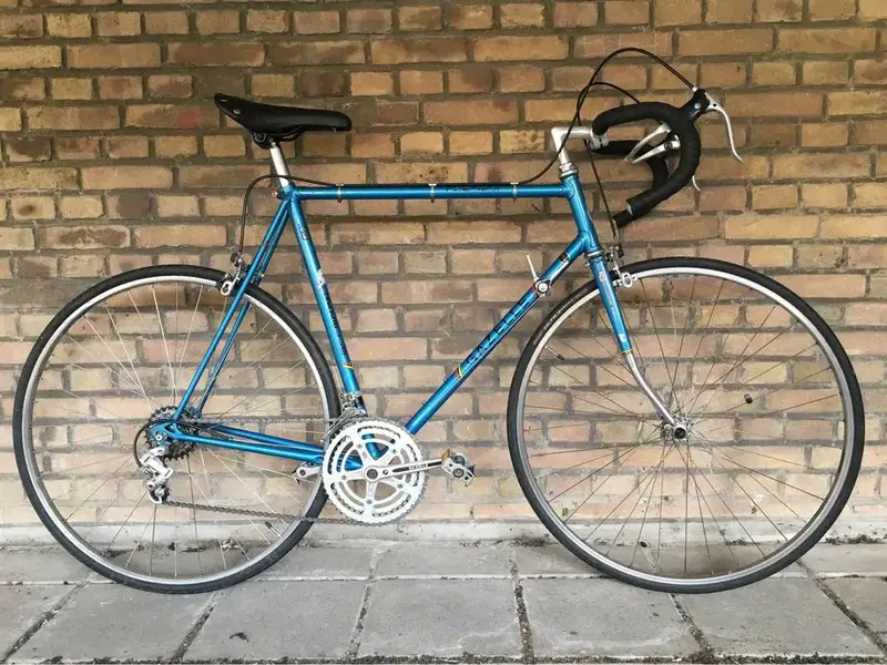

This is a Tour de l'Avenir, build looks similar. I think the frame tubes are butted still. I had one and it is a fine semi race bike. Probably eighties I think. EDIT not a champion modial
That definitely looks like the same frame (to my untrained eye anyway!) Cant see what the crank set up is on this gray one or the RD etc. But set-up looks nice on that blue one!

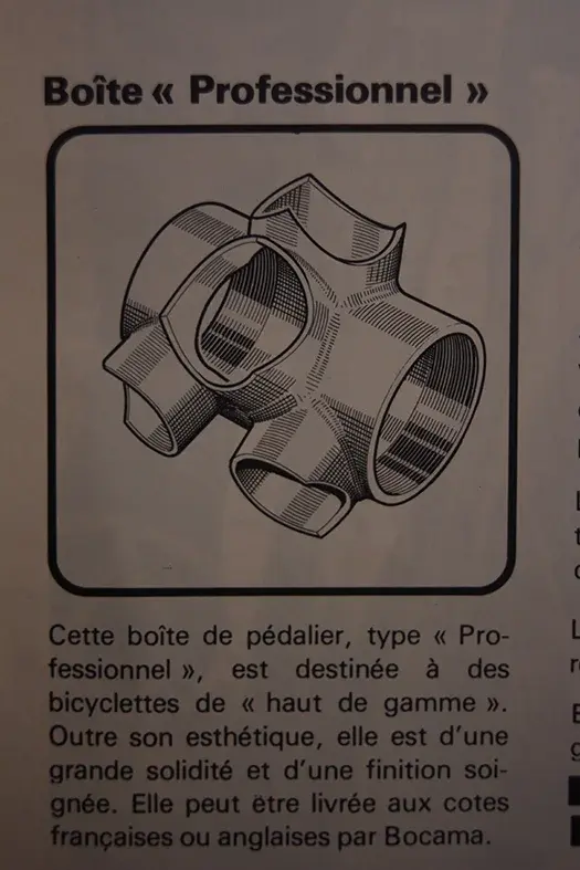

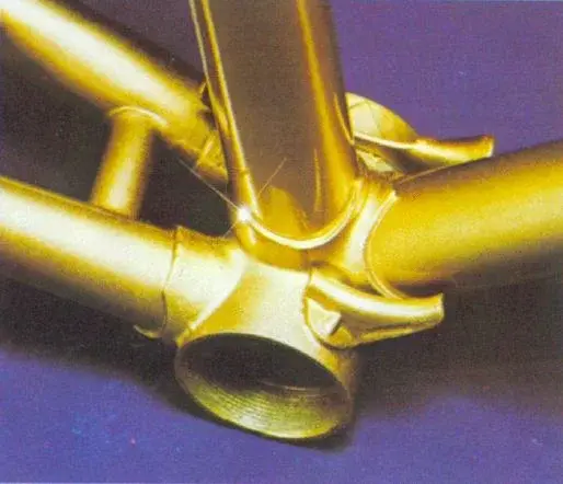

shells on the Champion Mondial at this era were typically BOCAMA Professional
here is a closeup of a '79
