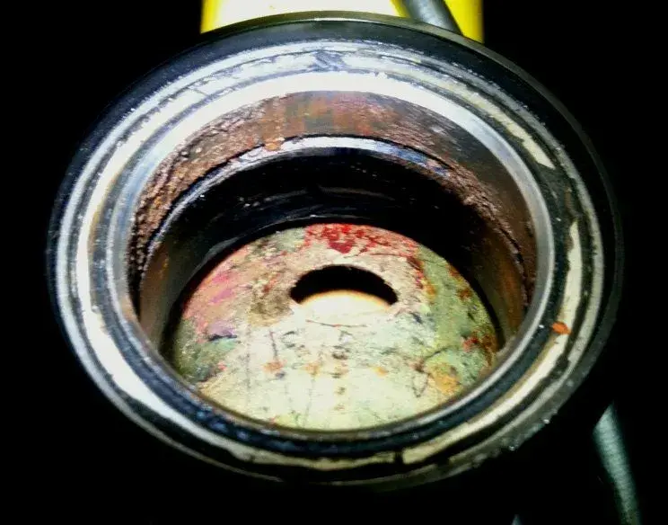

Just out of curiosity I gently removed the fork and took a peek inside the head tube:

Depending on the framenumber this is (was) a Gazelle. Decals "Boulder Bicycles Inc." point to 1992. What is that seat tube diameter modulation for? Your head tube is interesting as well. Is that enamel?
Your information (and the trace of red paint in my ht) confirms, repaint probably in 1992.
Seat tube appears to be sleeved all the way down to the top tube. My literature states that frames after 00200 changed over to the larger diameter.
Not sure about my head tube badge. It doesn't appear to be enameled. Do you know if these were case aluminum or maybe silver?

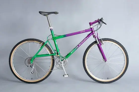

Found another very similar Gazelle, with the Team Fade, sleeved seat tube, and other similar features.

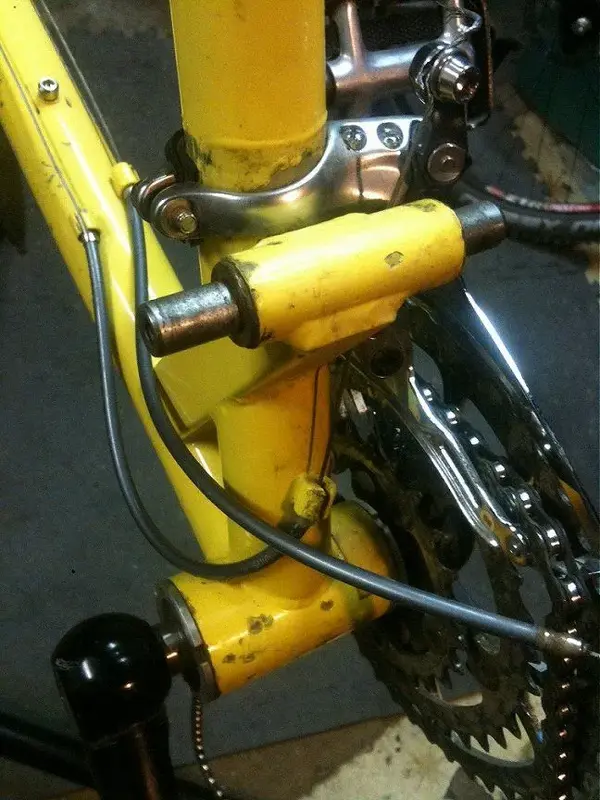

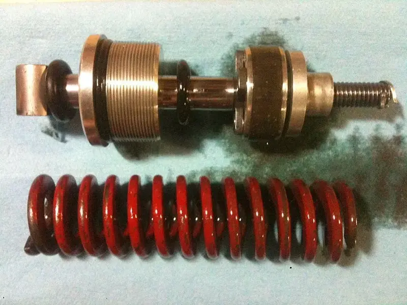

Spent a few minutes over the weekend looking over the rear suspension.
There is a fair bit of play in the lower linkage and given the overall state of neglect I assume the routine maintenance of the lower pivot was long overdue.
With rubber mallet in one hand, Red Hook (ale) in the other I proceeded to disassemble the rear swingarm.
Pivot shaft fought me a little but it gave in eventually. The shaft rotates on bronze (I think) pressed in bushings and is held in place by bolts torqued to 7lbs on both sides of the swingarm. The shaft seems to be in decent shape and fits tightly in the swingarm, but I think the bushings in the main frame have worn to the point that they will need to be replaced.

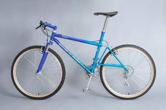

Not not sure about colors right now, but i'm really taken with this 4 color fade.
