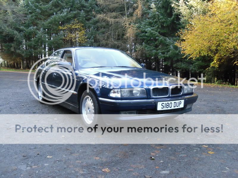

BM has 159,000 on it, mainly motorway miles i think, has a full service history, working on the heater at the moment, pretty sure it's the valve (needing stripped and cleaned/tested) and not the core.

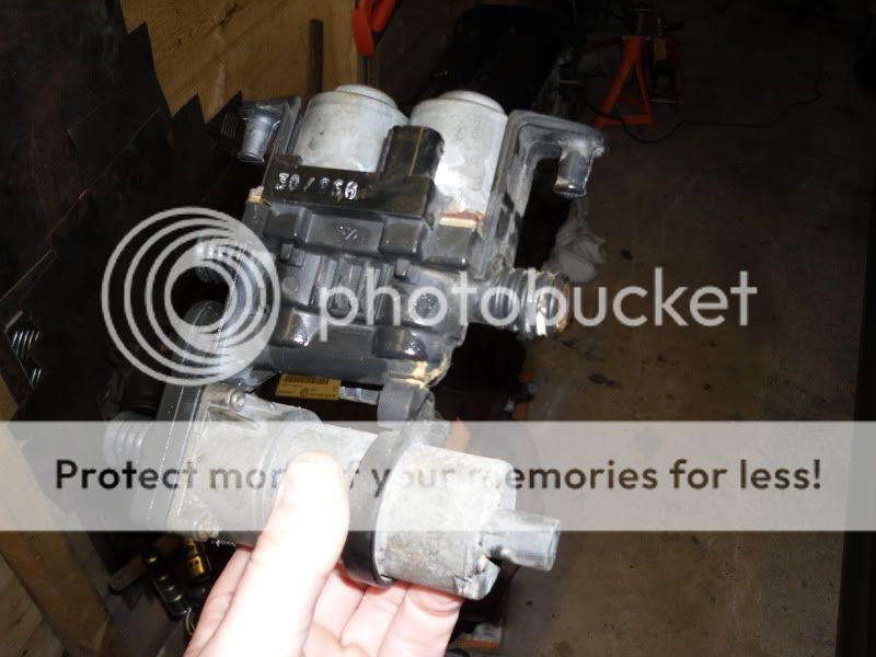

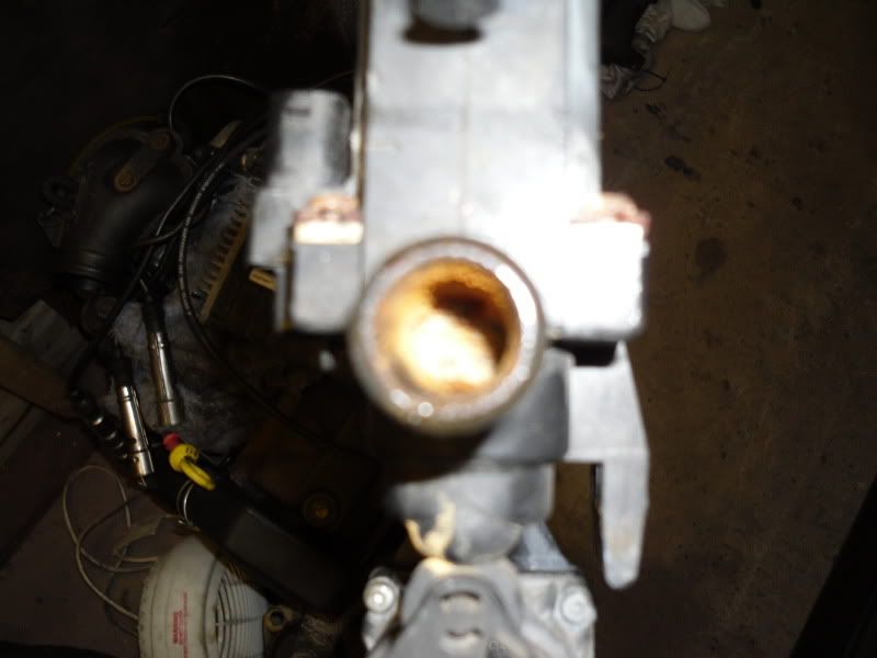

Got the heater valve off the BM thismorning.
The cause of the problem, totaly blocked, the result of years of coolant with no corrosion inhibitor.
What a mess :roll:, was hoping to salvage it but seals are nackered and i cant get the plungers to work so whole new valve assembly i think.

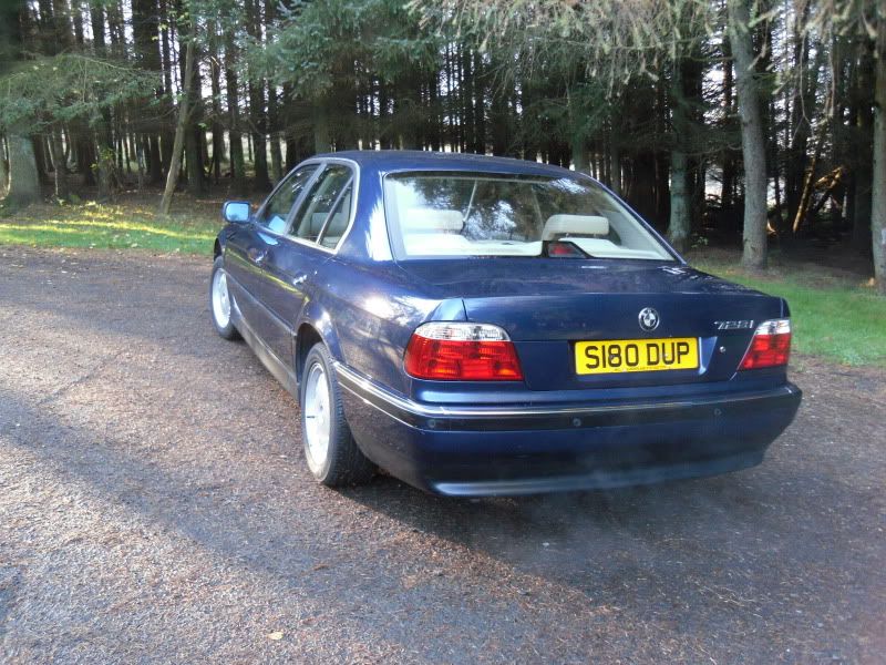

Been spending more money on the BMW :roll: , £200 in the last couple of weeks :oops: , read on the net somewhere though that BMW actually means Burn My Wallet :lol:
Got the late spec clear/red tail lights to replace the faded, cracked originals.
Clear front indicators.
