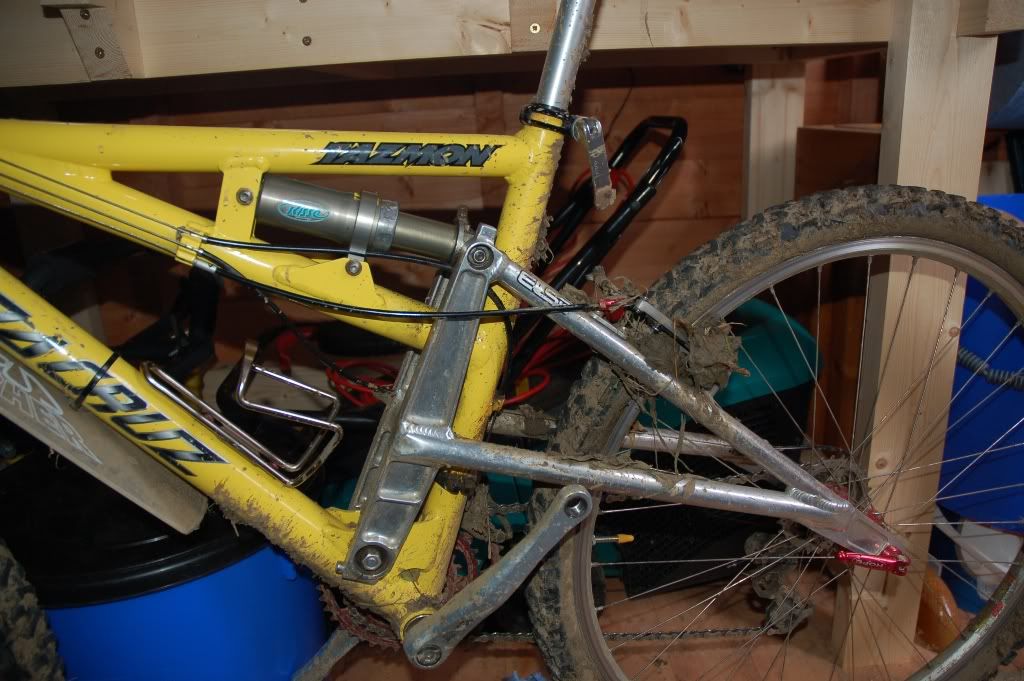

ouch....that is a rare size :shock:
any chance of some closer pics of the rear shock assembly..and the mounting points?

(sorry for the dirty photo, the poor thing has had a quick clean now)
The shock has slowly been leaking oil for a year, but keeps its air pressure ok.
From its normal resting position I can get it to extend about another 3-5mm if I lift the frame up. I don't know if this should be counted as part of the travel or not.
I'll have another measure up without adding the loose travel, it would be good if it was a standard size!
