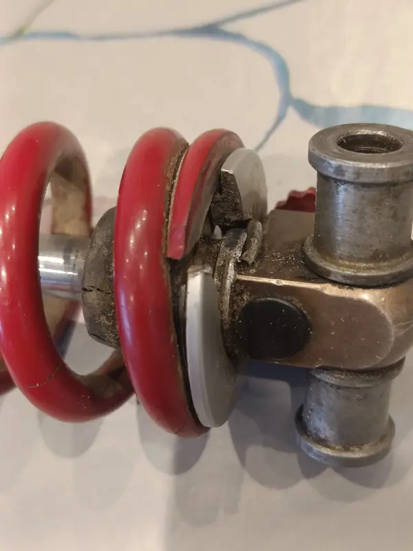

I wanted to send the shock off to RetroShox for a nice service but the bottom flange on the lower leg is partially burred/bent on one side (see picture)
The coil and retaining plate stay firmly in one position under compression and from what I remember it was always fine during riding. This is just something I noticed when I was fully stripping the frame down and I'd like to try and get it sorted.

This happened to my original Coupe Deluxe back in the day and trashed the shock. Weren't many options even back then and I had to replace it with a Stratos shock. Watch any replacements as around that time there was also the LTS DH which had a different stroke. I made the mistake of buying one for my standard frame and the tyre hit the seat tube under compression. Not sure which of the sizes the DS uses, so check first.
Good to know, thank you for the info.
I'm on the look-out for one that is identical, as I have seen several variants when it comes to the design and machining of the top and bottom around the eyelets and damping/rebound adjusters.
The other option I am considering is having a local fabricator weld a spot of material into that position then shape it down.
