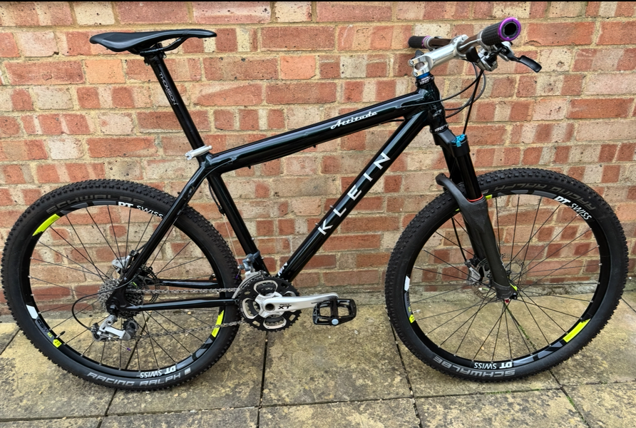

Thank god as I was starting to get quite anxious I’d never get it sorted or was going to have to take it to the LBS anyway here is the build. Still need to swap the stem out for a black one and I can’t quite get the front mech to shift into the big ring - which I think is due to the external BB and chainset just being two wide/long so might change for a M950 BB and chainset
