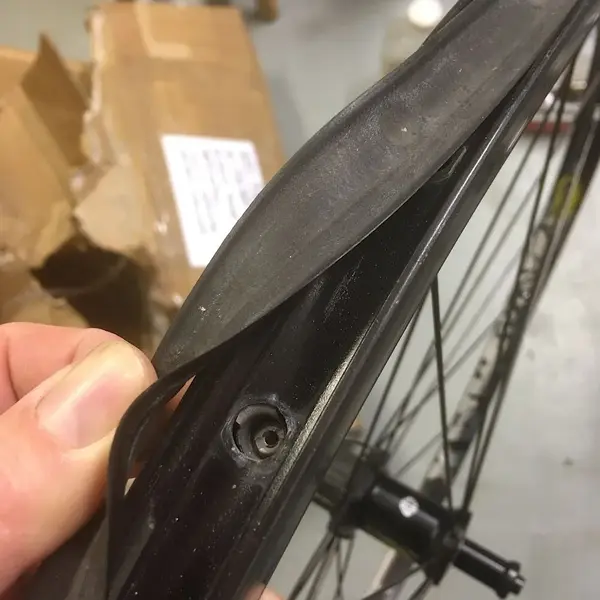

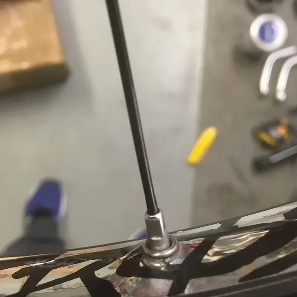

Check the eyelets closely though before getting too deep in to them, the rim had a tendency to crack around them, even after a year of use!
Great advice!
Just checked the rims and yes... the rear one has a cracked rim at one of the spokes.
Received them late yesterday so just had chance to open them up.
Will give the seller on here a shout to see if we can work something out as I guess this is toast now and I paid good money for the set.

thats the weak spots on all 1st gen. Crossmax - cool looking, lightweight - but fragile. Rear rims are more prone to crack then front ones. Replacement rims are rare as hens teeth. Sometimes these had been replaced by standard Mavic 217/517 rims, with or without ceramic coatings.
Sorry to hear you paid good money for it and expected to get a crackfree set.
