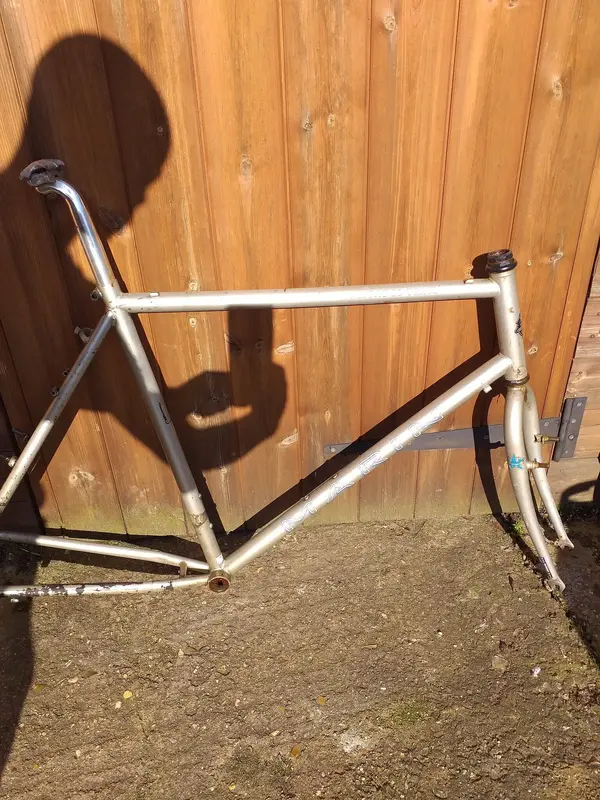

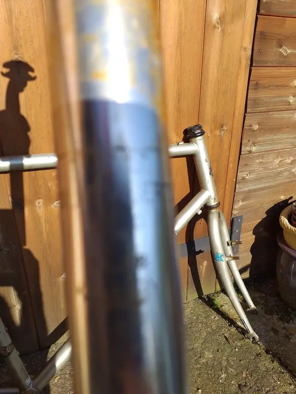

I've got a marin palisades frame with the post as well , I'll check this afternoon for you 👍
Unsure of frame year .
Seat post is stamped 91
And 27.0mm if that helps mate
