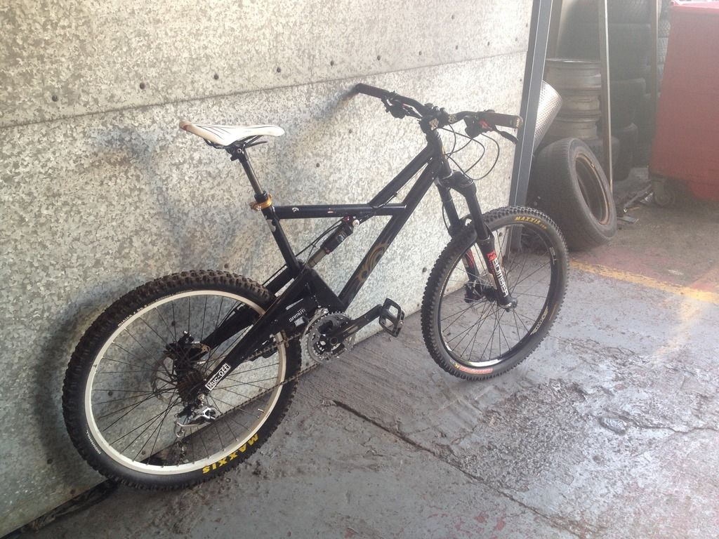

Is this what you're looking for ?, a friend of mine has just dug this out of his spare room , bought new in 98 and hardly used !!

The 2 bikes LGF has posted pics of on 1st page have different lengths of swing-arm, the 1st one with what looks like the Marin caliper mount is the longer one. The 2nd V-brake only is shorter. The one posted by Matthews looks to have the same longer arm as the 17.5" Wild Cat Trail had, with Marin caliper mount.
The shorter arm, I just measured them, is 450mm from shock mount to drop-out, the longer arm is 470mm although I wasn't able to get as accurate a measurement with this one.

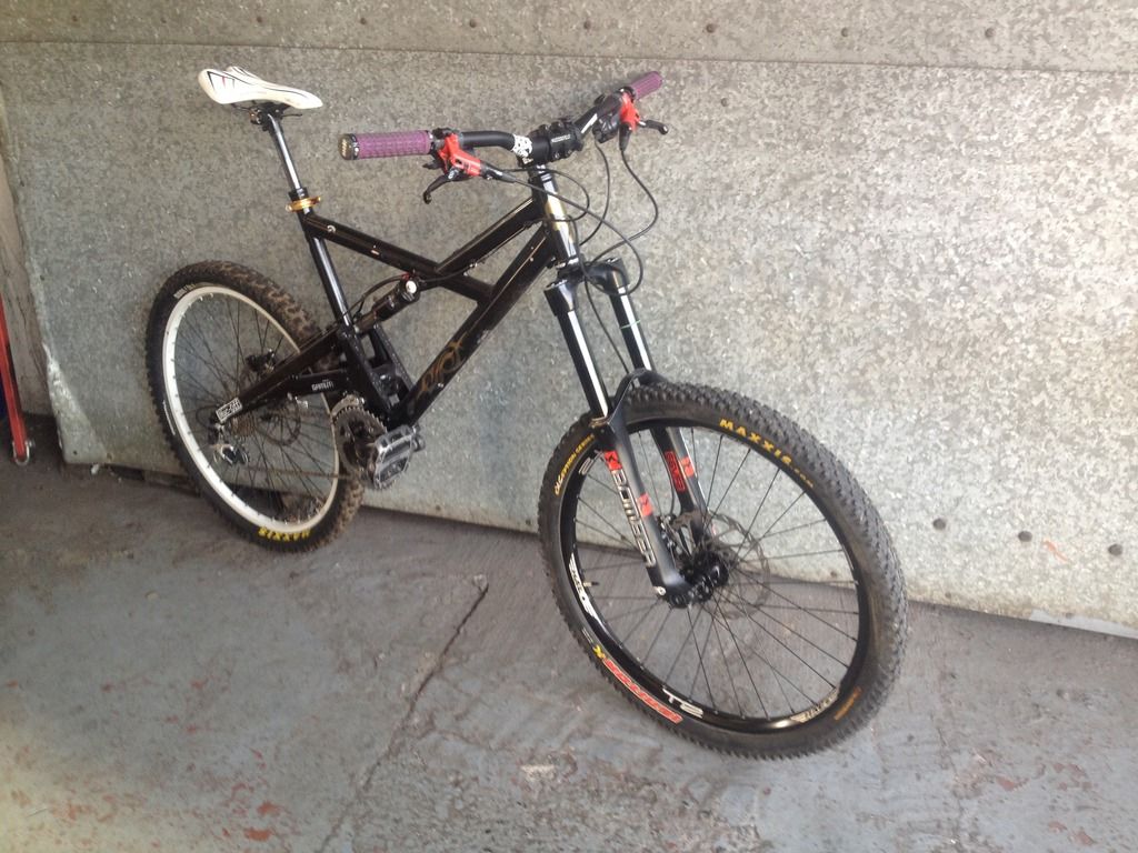

Finally on it's wheels. Didn't get a chance to measure swing arm. New jokey wheel for mech. Set the sag and it's ride time.
The one in pics above looks like it has the longer arm. On the 470mm arm I have the distance from drop-out to the piece of alloy plate reinforcing on underside of arm is where the extra length is. Yours looks the same so it could be the longer one but not possible to be sure just looking at a pic..
Measured today, rear arm is the longer 470mm arm so I'm happy with that. I increased the rear shock pressure from 120psi to 230psi and now sag is spot on. Need to rebuild the rear hub bearings, swap out the free hub and ideally get an adaptor to play with the air in the forks. Then it's ride time "Project Accident & Emergency" is taking shape. Thanks for you input guys.
Well after a couple of rides I can say I'm really impressed. Forks I think are a bit too long for going up hill but it's so much more capable going down than my mount vision. The plan to strip and re finish may be considerably delayed due to use.
