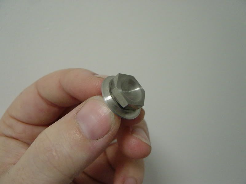

I also made some load bearing washers for the crank bolts but the combination of these, the x-lite caps, SRP bolts and the shallow holes on the Ritchey crank made the dust covers slightly proud :? The washers and bolts got modified to solve the issue :
