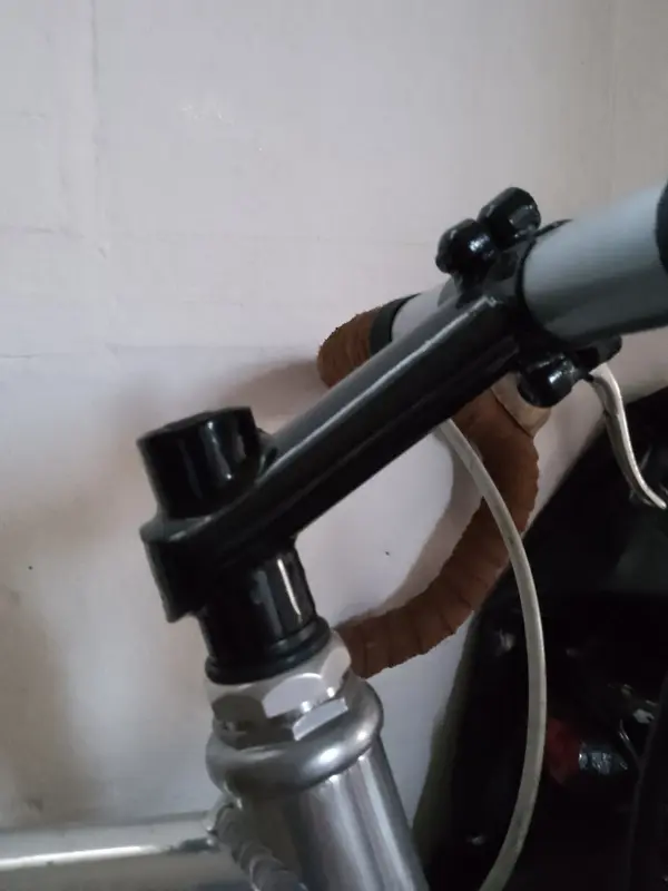

Now these are interesting stems....just before ahead came out I believe it's a double quill one clamps steerer the other clamps stem open face too...I'd have half a dozen of em in this size but I've never seen another!

So, I was thinking that'd it'd be really neat for stuff like height adjustment, looks and also it'd make people go "You're not quite right in the head, are you?" and out of pity they'd get me stuff from the supermarket.
Mickey, am I right to assume you mean that I have to take care of where I wedge the quill in relation to where my collars are? That's a good point.

Yes...the clamp to hold your headset together would be most happy if a big old wedge isn't trying to make it out of round....round bar round clamp is good it'll hold fine but make em out of round bad! Shock load would probably make it budge.
It's doable for an off road type bike.. I'd suggest a clamp that's a damn good fit and one that isn't slit all the way through however that's making it quite chunky ...whereas on a road bike you'd get away with it more but off-road I'd err a bit.
