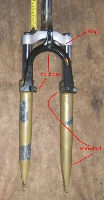

MAG21 '93
Same brace as the MAG20, but the crown will be smoother with a sort of 'ring style' just above where the stantion goes into it.
Fork brace with 2 holes under the canti hanger for reflectors, but these can be changed for newer ones, fork could be changed though
lower tubes smoother <- main thing to look for and only real give away

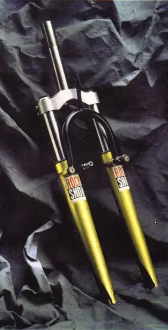

MAG21 '94
Different smoothed and more milled than '93 also the 'ring' styling has gone.
Different dial, they are a chunky machined CNC types rather than a thin dial type.
Brace changed, only one hole for the reflector and 1 position for the canti springs.
Alu (gold) stantion tubes (so this one is really easy)
Internals are different now for improved riding.

My '94 MAG21's
Notice the crown change (smoother still, not ring underneath and more cut out between the head tube and stantion tube).
Notice the dial change.
You can just see the gold aluminium stantions poking out as well.
94 Mag 21 (SL/Ti) seen here.
