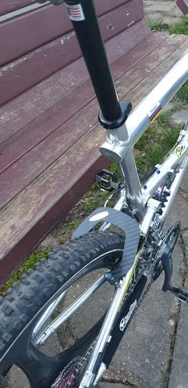

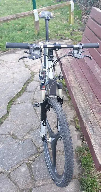

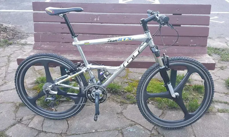

Just over a week ago I had no rideable bikes. Now I have just completed a fourth, my GT Team RTS.

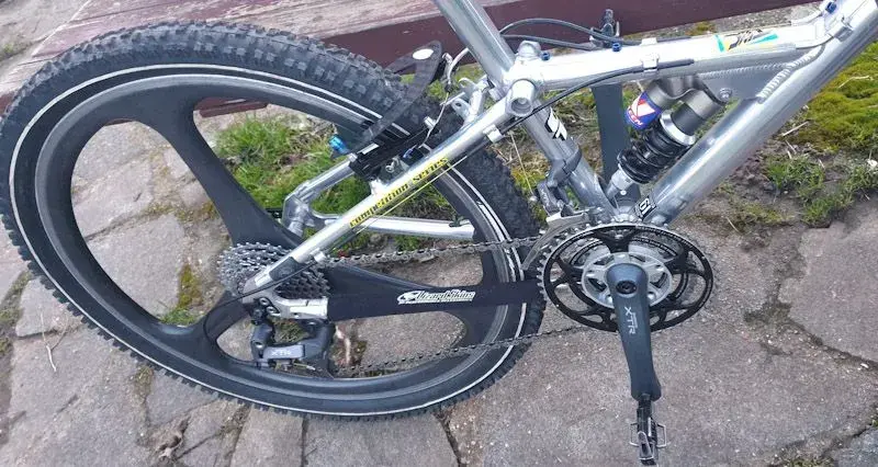

It has been hung partially built for a while after I started a rejig but stalled. I decided to stick with the m952 gearing and cranks, I really like the hershey spider.

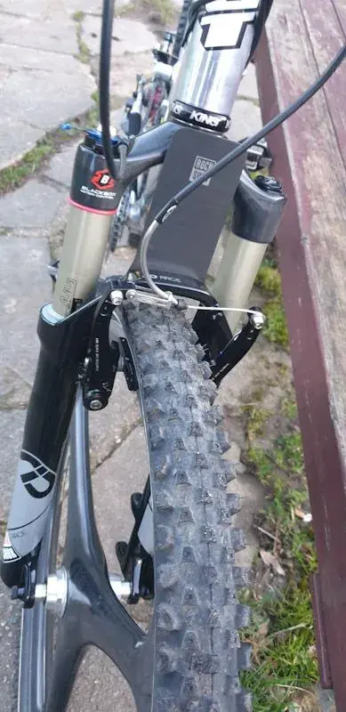

Brakes I switched over to some avid ultimate at both ends and levers. I fitted a fibrelyte booster at the back, may swap it out for a black odyssey though.
The forks were swapped over to a set of rock shox sid world cup. I built these myself from nos parts I bought over time, it just took me a while to get the courage to cut the carbon steerer. I left it at 220mm which is probably too long, bit I didn't want to go shorter. Lowers are nos race, might update the decals as I have a load.
Spins also fitted, complete with some x-lite tech 9 skewers.
Rides great, a few decisions still to make:
Swap the noleen for a risse (I'd lose damping adjustments but lighter and newer).
Decals. I have some for the spins and the seat post and stem (controltech). Not sure whether to fit them or not.
Brake booster change. Not sure i quite like the blue x-lite bolts either. Might go to black.
Saddle. Might pop a use carbon on.
Thoughts welcomed.
This will be my last build for a while, gt lightning next.

Nice build. What is that funky XTR crank spider? Never seen anything like it before.
Also: Holly headset spacer stack batman!
Spider is hershey racing. I've only ever seen one other myself.
Yes, lots of spacers, didn't want to cut the fork steerer any shorter. Did have a spacer on top but swapped it over as it looked worse.
