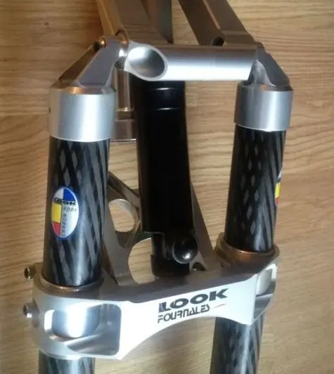

I am fortunate enough to be the new owner of a set of look fournales after purchasing from here. I've always wanted a set since I first saw a set on a build thread, and probably a decade later I now have some, as they arrived today.
The plan was to fit them to my GT Team RTS, as I think they will look great on it alongside the spin wheels, avid black ops brakes.
Has anyone done this on an RTS as I'm keen to see what they look like before replacing the nos 32mm Sid world cups I built for it.

Which model do you have, Ian?🤔
Mk2 has the flat face plate bolted on, Mk3 has the hollow CNC brace at the front.
The Mk2 has a couple of 608 (std skate) bearings and the rest are bronze bushings with grease injection ports inside the axles.
The Mk3 is 608 bearings all round, so those can just be pressed out and replaced easily if needed.
Disassembly is pretty straightforward for both versions. Remove the end caps/bolts and swing apart, no nasty surprises.

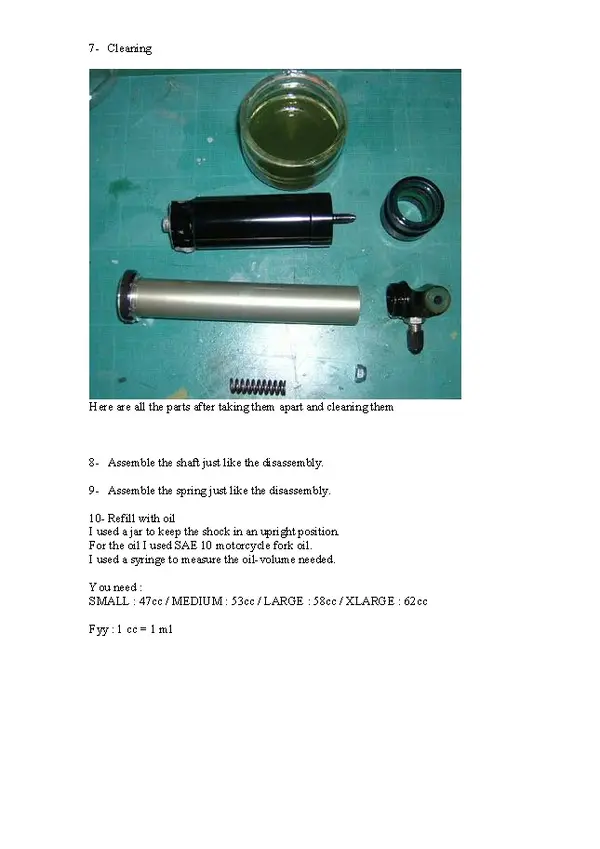

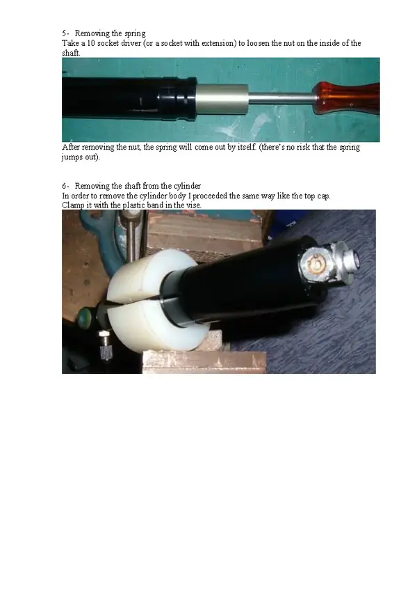

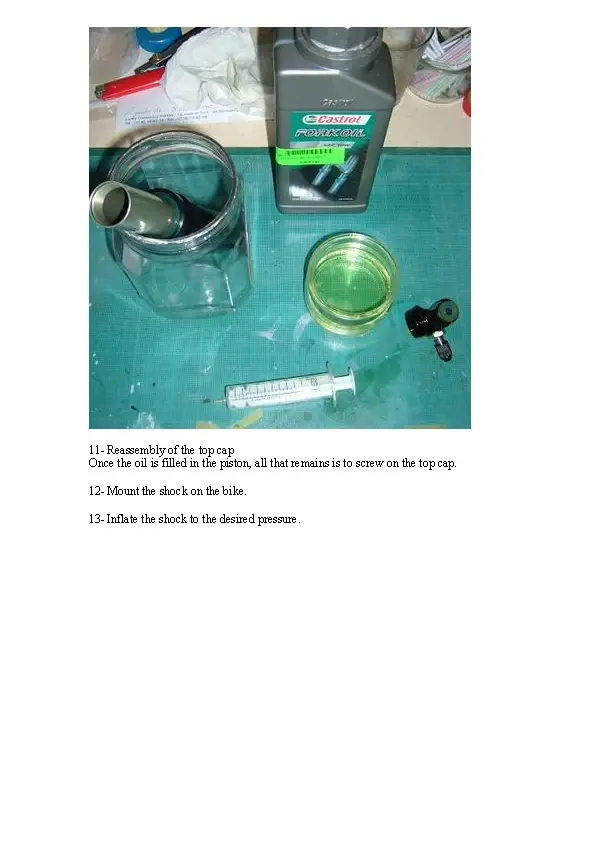

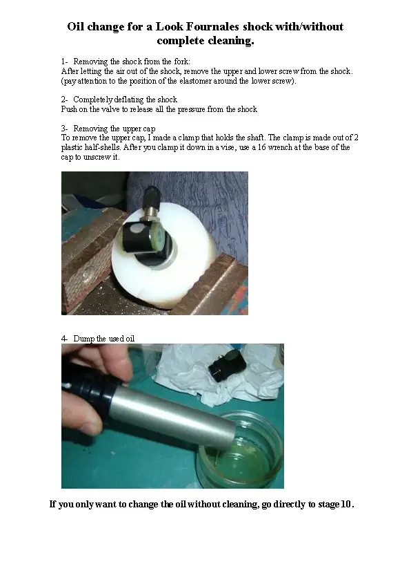

Here's a guide I found to servicing the air shock:
Oil Change for Look Fournales damper_Page_1.webp Oil Change for Look Fournales damper_Page_2.webp Oil Change for Look Fournales damper_Page_3.webp Oil Change for Look Fournales damper_Page_4.webp
