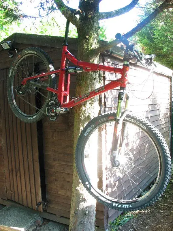

I may be biased :)
(apologies for modern parts...)
