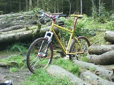

Ok you guys , we got the other thread going on which envelopes plastic , ti and alu .
But what about steel ?
My Lobster . 19.5" c to top flavour , a knats whisker under 4lb .
What about all you Mountain Goat , Fat , IF , Kelly , DeKerf owners out there ?
Lets just see if there are any medium frames from some obscure , long forgotten manufacturer that can hit a real life 3.5lb .

Sizes aswell as weights please lads an lasses (dont want the non converted thinking we are rigging the game.) :wink:
Chas May told me that he built a few super light specials in 753 in the early 90's, but of course they broke in time. They were significantly under 3lb.

I think a 3.5lb 18x22 steel frame would be too flexy even for me.
BITD the lightest Tange MTB tubeset was Prestige Ultimate Superlight. That weighs what it weighs, a frame built by a bling builder can't weigh less than one built in Taiwan with the same tubes (and in fact fillet-brazing adds c100g over TIG welding so I understand). Add welds, bridges, dropouts and paint to a Tange Superlight tubeset and you're over 4lbs.
But I did say MTB. There's no law against using tubes intended for road frames and not sanctioned by the maker for MTB. But you'd have a sub-4lb frame that would be too flexy to be fast and too fragile to last long.
