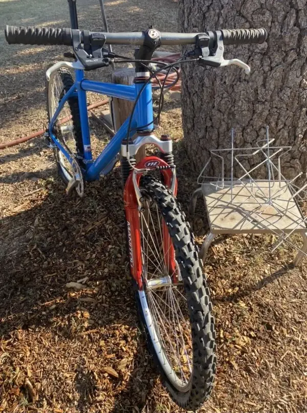

Hello, came here to post KU206. I’m not sure of the year but I picked it up in Chico in 1998. It was a raw aluminum frame that I had powder coated AE691018-A3E4-4762-B7C4-207F8495D30D.webp in this blue.
Hello, came here to post KU206. I’m not sure of the year but I picked it up in Chico in 1998. It was a raw aluminum frame that I had powder coated in this blue.
Hello and welcome to Retrobike.

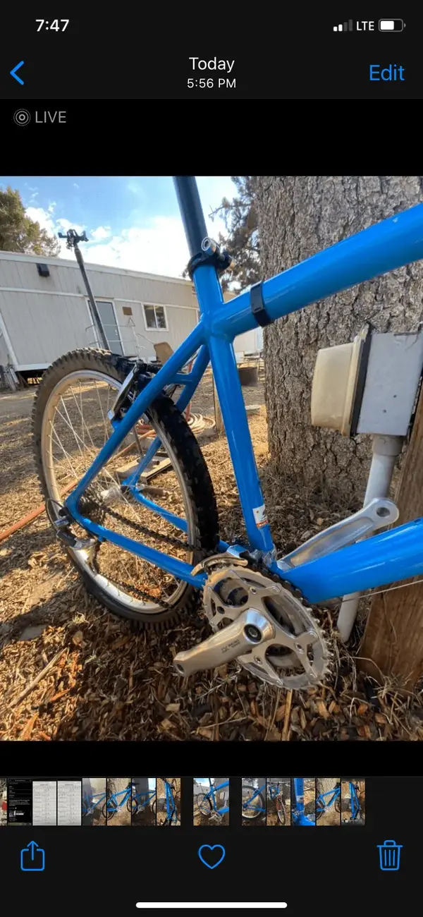

Thank you very much for posting this. With a Serial Number of KU206, (with no zero between the "U" and the "2") your frame likely to be a 1995 model. This can be confirmed if I could see the Cable Routing on the Top Tube.
If there is no Cable Stop at the rear of the Top Tube for the Rear Brake (which the require a Dog Collar) then your frame is indeed a 1995 model.
The 1996 models do have Cable Stop toward the rear of the Top Tube and therefore do not require a Dog Collar, or what looks like a Top Tube clamp on band in your picture.

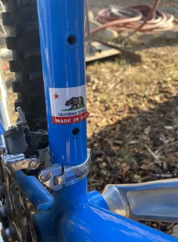

Could you kindly take a picture from the non-Drive Side to show the Cable Stop arrangement, and also a picture of the Serial number, which will enable me to add your frame to the Kona KU Serial Number List.
Finally, we know that the 1995 and early 1996 KU was welded in Chico at Altitude Cycle Technologies, but are you saying that you bought the frame new, with no paint in a raw finish, with the option to have the colour added yourself?
Many thanks,
Pip.

I bought the frame from one of the welders from Altitude. He and others saved a few from the forklift when they crushed the frames post contract. I got it painted and bought a component package that summer from a local shop. Stand by for the serial, I’ll get a pic.
