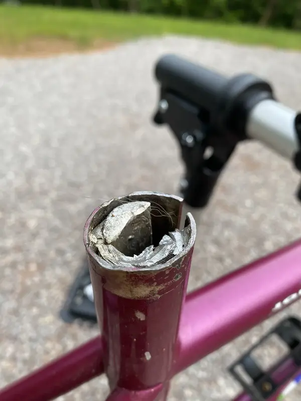

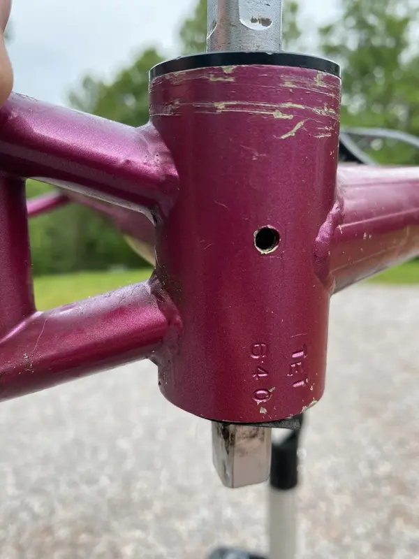

Hi there Elijah, this is a 19" 1993 frame with the Tange Ultimate Ultrastrong Ribbed Down Tube - lovely colour.
Could you take a picture of the Serial Number please, so that I can add it to the Hot Serial Number List.
You mentioned picking it up for free, and a stuck Seat Post; perhaps you could start your own thread in the Reader's MTBs --> 1997 section.

Thank you for the picture of the Serial Number. I will add the frame to the List when I next update it.
Err, I see no stuck Seat Post in the pictures that you have posted, so is there a section of Post stuck inside the frame that we can't see? It looks that this may be the case in that first shot, which will make the task more challenging.

Its pretty rough, the previous owner tried a couple things, im considering filing it and just using it as a shim 😂
Perhaps you could start your own thread in the Retro MTB Chat section with regards to removing the remaining part of the Seat Post, and maybe the Reader's MTBs --> 1997 section for the potential build.
I would think it entirely possible to vertically hacksaw down through the remaining sections of Post and prise it out.
Pip
He already tried that, but he thinks its chemically bonded to the frame
