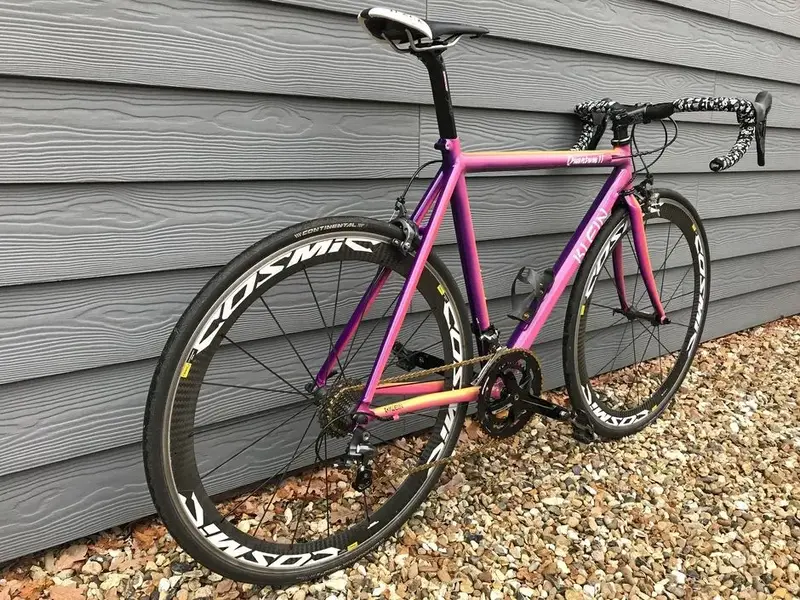

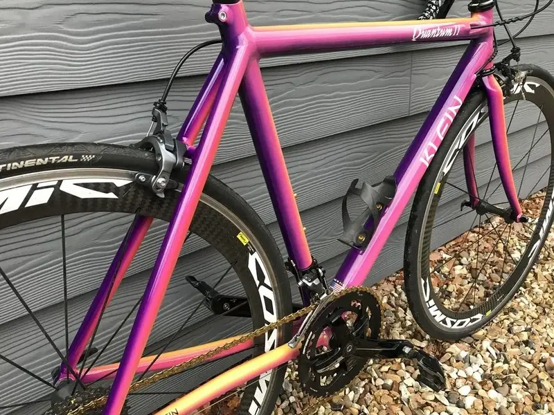

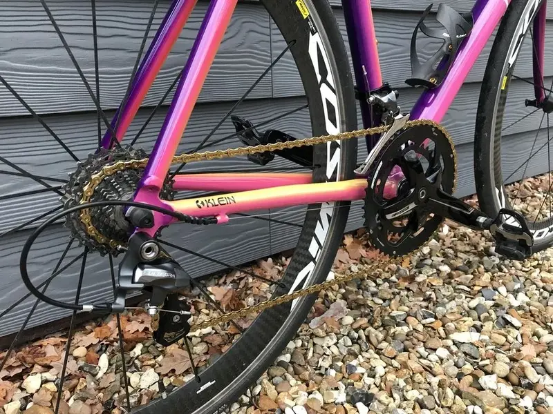

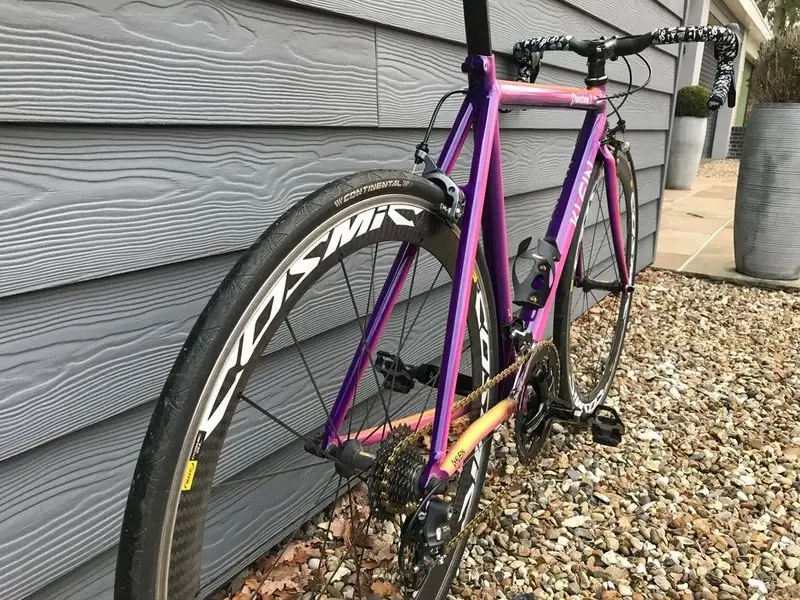

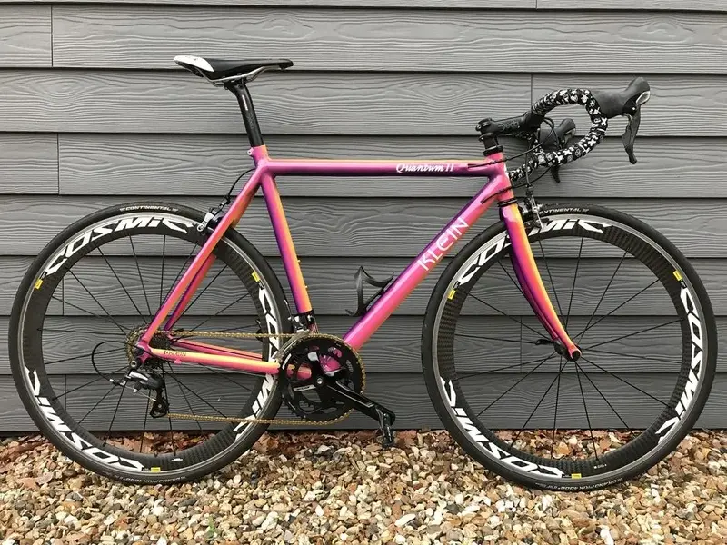

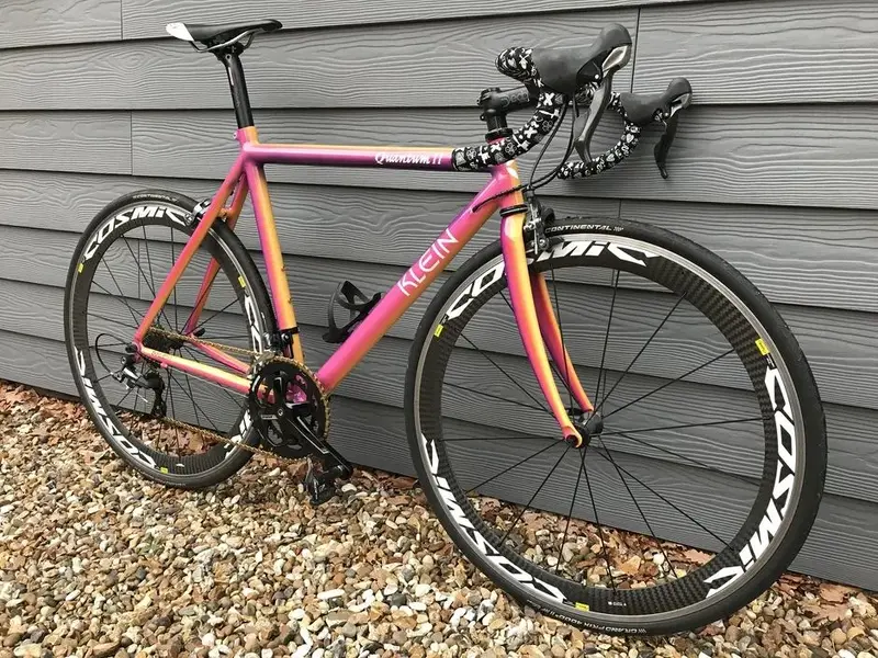

Just finished this Klein 1996 Quantum II restomod.
I wanted a ‘cafe’ bike for easy social rides. Having fallen in love with Klein bikes 20 odd years ago, there was only one choice... a Quantum of some description.
Bought the frame and original folks off eBay. Had the usual range of chips and scratches but no dents or cracks. Stripped it back to the bare metal and treated some minor corrosion. Replaced the folks with carbon folks (still have the original ones in case I ever want to go back to the original setup).
Resprayed it myself. With the benefit of hindsight, I would have used a slightly brighter pink but I’m pretty happy with how it turned out.
Most of the components came from eBay. Excluding my time and the wheels, which I already had, the total build cost was less than £1,000.
I’m now on the lookout for my next Klein project bike.

Great job, and i love the paintjob!
Now, from a purely aesthetical perspective (my own that is), i would probably try to source an ultegra crank to have more uniform shades of black, and add a totally black saddle and bar tape to make the awsome paintjob and those sweet cosmic's pop just a little bit more.
