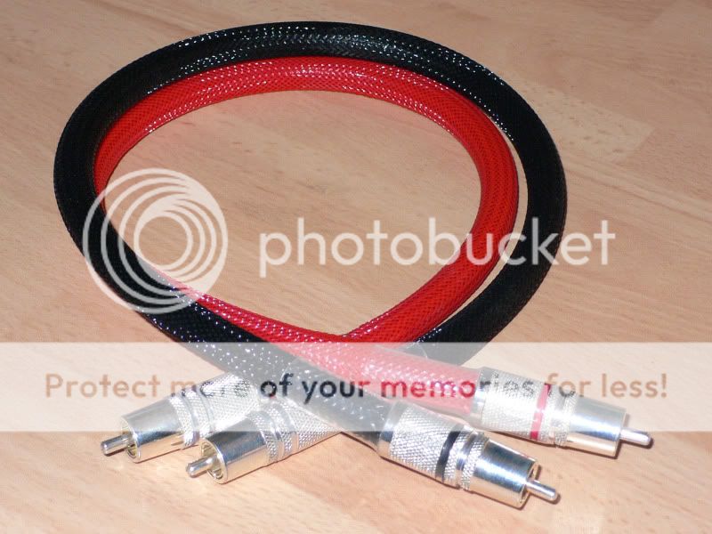

As it is, I make these now...
...and I charge a lot for them because you can't get better... 8)
