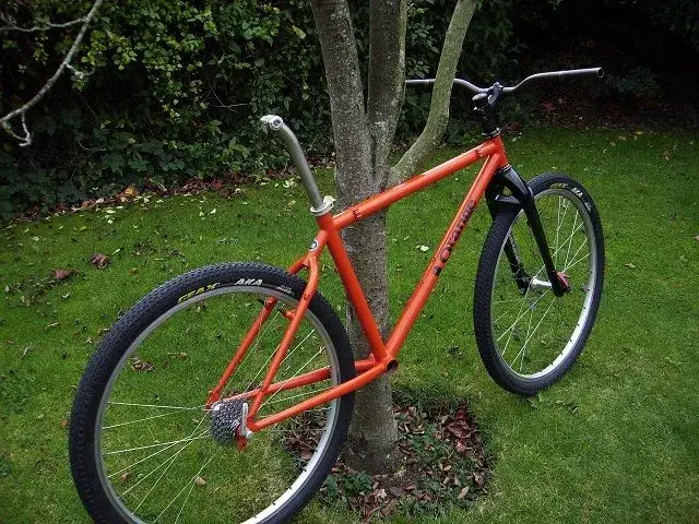

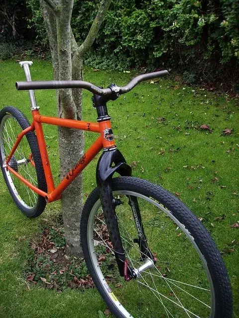

OK, so going quite well despite having various neighbours and a landlady intrigued by the sound of a hairdryer in the car port, and time wasted having long conversations about home made headset presses....
BUT have 'lightly' waxoyled him (hence the hairdryer), removed some of the annoying decals (saved but as you know, I may not keep him forever and they can go back on :facepalm: ), test fitted a BB to check threads before the waxoyl went in, and now am at this stage....
Love the tyres, hate the fact the yellow clashes (we won't even mention the mauve and yellow Mavic rim decals.....), bars and stem definitely not staying (Kona stem is for something...else....) and obviously that steerer needs some drastic cutting down, but 1) not confident on cutting a carbon steerer, and 2) better not overdo it as this frame has an extremely short head tube, next frame might not... (again working on the theory I have a reputation for not keeping things for long)
This afternoon's job, polish up that paint work, it has the most amazing sparkle hidden within it's depths....then make a decision on chainset, which will probably involve selling all the ones I have, none of which are suitable, and buying a Middleburn, or possibly an old LX M563, as the colours would suit and I have a 94BCD ring ready for them.....

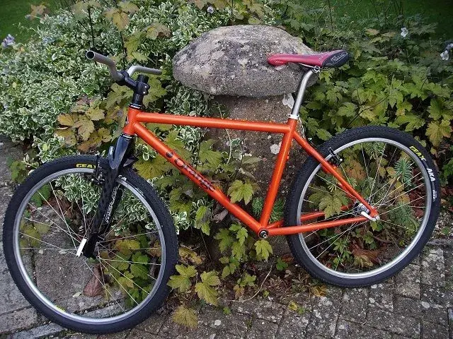

I've just come in while I try and decide what I'm doing. So far today this bike has been 7 speed, 8 speed, and now having discovered an exceptionally lightweight close ratio road block, it's going to be 9 speed.... :facepalm:
Feel the need to start selling some more bits to fund all this....
As it ended up by the end of play, weight as is, just under 18lbs....if my calculations are correct!! :lol:
