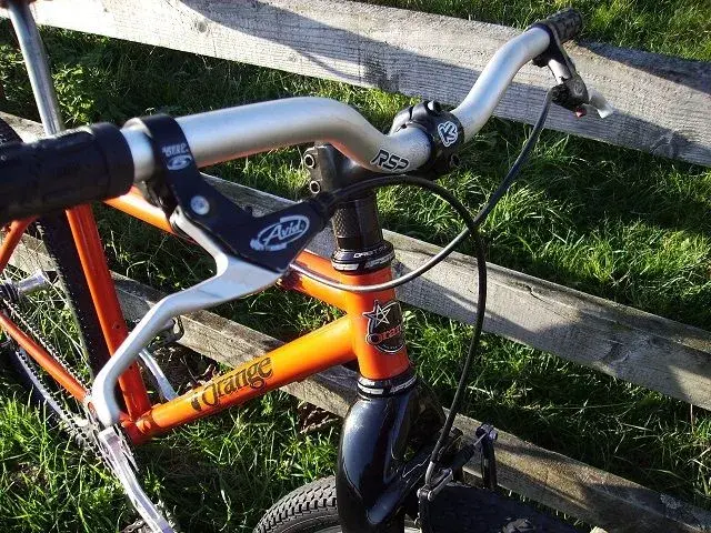

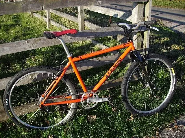

So....he's pretty much there! Still need to cut steerer but haven't decided if the bar/stem combo will stay, as you can see it's a bit of a mish mash branding wise.... :facepalm: But then again, it's all light and it works, so....

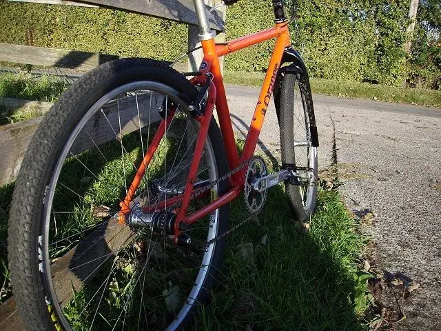

First impressions after a couple of shake down rides along the drive way - saddle height needs to go up, it's amazingly quiet, for some reason I expected a lot of noise from the SS transmission, headset had to be tightened a little, but apart from that....I can see this easily being my 'go to' bike for a very long time!
It's compliant, quick, and super light without being twitchy, best guess using the bathroom scales/weigh yourself/weigh yourself holding the bike method is 21lbs exactly. Seat post will be going as I hate it, it's steel, and it's shimmed, so although it may take a while as it's an odd size, I will be looking for alternatives, also possibly a new and lighter chain, maybe even a lighter saddle than this one. It's from the back I want to lose the weight, as it's scarily light already on the front end, not that it's twitchy as I say. Would be nice to get him down to 20lbs, without spending any more than a few £'s (ebay have some cheap posts, light, could be cut down a fair bit to save more weight....)
Anyway, here he is, not the best pics as sun was low and so was camera battery.... :mrgreen:

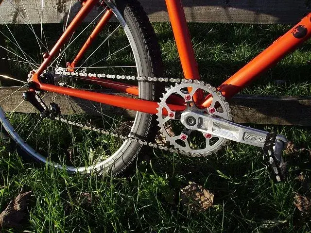

Still having the debate with myself about putting the chain ring on the middle ring setting (if it will clear the chain stay like that) so that I don't have to run the rear cog so close to the outside of the hub body. Maybe I just won't worry about it..... :facepalm:

I would definitely recommend putting the chainring on the inside. I've already knackered a freehub on a single speeder. I reckon all that standing on the pedals shortens the life of the drivetrain.
