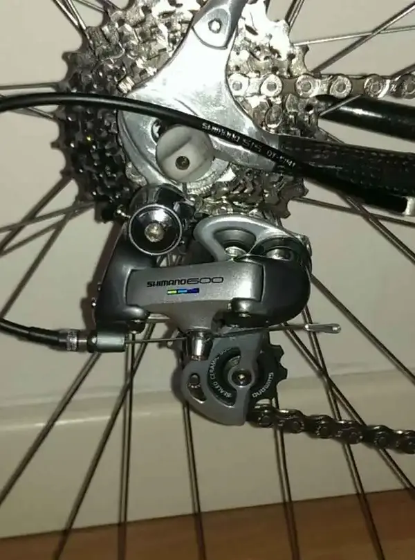

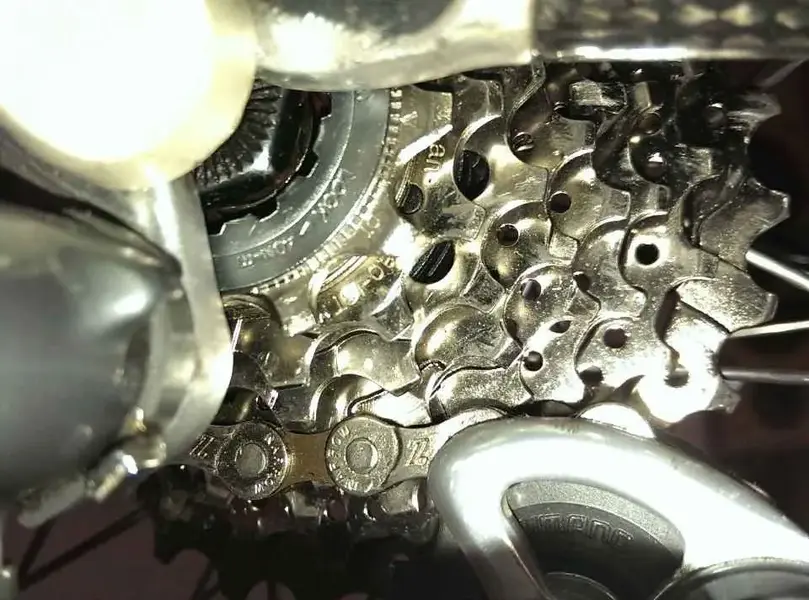

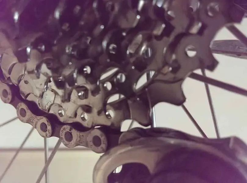

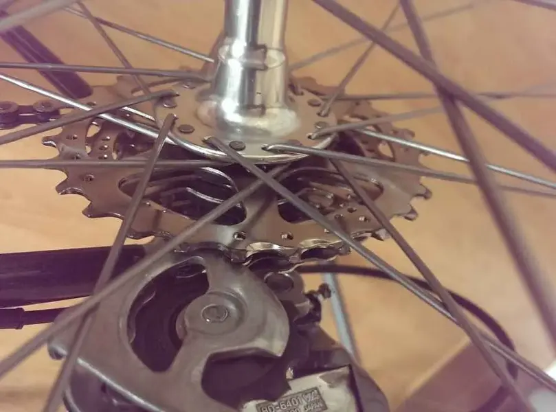

Afternoon Shaun. Mine's the open cage version. I've attached some photos which (hopefully) show the issue.
Top picture - jockey wheels when on 52T - 11T.
2nd picture - on the 5th sprocket - no issue with hitting.
3rd picture - on the 7th sprocket - cage hitting 6th sprocket.
4th picture - on the 8th sprocket - no issue with hitting.
As you can see the proximity of cage to jockey wheels is fairly close on most sprockets, but as already described it's just the 2 sprockets where it is actually hitting. There is obviously some part of my set-up that isn't quite right, although what that may be is a mystery to me.
Gav - Hangar is straight, dropouts are straight, frame is NOS - the RD has very little mileage, cranks are NOS, BB is brand new out the box - I'm leaning towards this being a chain-wrap / chain length issue?
I never ride big to big but I've just tried it and it won't reach, the RD goes to it's maximum 'forward' travel and locks up before the chain has fully engaged - could this be the problem, i.e. not enough links in the chain?

Hmm........."Slant Pantograph" mechs should be a bit more parallel to the chainstay than that.
Shaun
It has to be chain length, on 42T - 28T the bottom jockey wheel is pointing forward towards the front of the bike, which can't be right can it? If I add more links then the 90 degree vertical on the jockey wheels when in big to big won't be achievable though, which I've always used as a set-up starting point. Perhaps this requires a slightly different approach.
