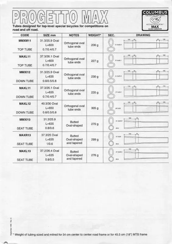

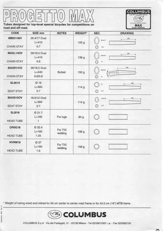

Is this Columbus Max?
Here's the answer to how the original MAX toptube was aligned.
The real MAX top tube is based on a 31.7mm tube and biaxially ovalized to 37.5x26mm with a .7/.4/.7mm butting profile. When installed on a frame, the 37.5mm axis followed the long axis of the head tube yet traverses the seat tube, meaning it is significantly wider than the seat tube, which creates either a really weird looking lug or a whole bunch of cool opportunities depending on your point of view.
http://columbusmaxbikes.blogspot.co.at/ ... about.html
1995 Columbus spec etc for all you MAXophiles:
All the best,
