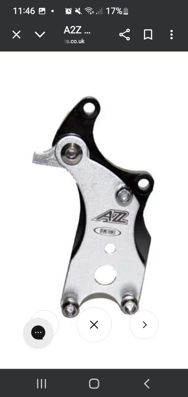

Look at your swing arm
You have the lower pivot bolt an the wheel qr axle hole
So if you made a piece of flat plate in a kind of crooked V shape using those holes to mount it an caliper would mount to other part obviously work those holes out when caliper an disc is on
Just had another look.
I think your best option is an A 2 Z rear brake mount it mount using the qr skewer an the two plates sandwich between the dropout
I did buy that set up off ebay, have it mounted with no apparent issues, am I missing something?
If that’s a 3 then it’s a 185 disk you need, if it’s an 8 it’s a 205, as this was a #3 plus 20mm on the caliper to avoid the need for an adaptor…
