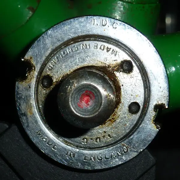

Installing fixed cup
Oh dear. I probably shouldn't admit this but I was trying to install the fixed cup on the wrong side! Realised my stupidity and used the bolt and washer technique. All in fine now except...
There is zero lot of vertical and horizontal play in the spindle. Would this be the bearings? Is it possible to still get replacements?

There were none missing and I'm pretty sure none fell out as they were caked in new grease and fairly secure in the cages. Could it be that the cages need squeezing in a bit to tighten them?
Cages? are those the same bearings you took out. I'm not sure caged bearings were about for BB's when your bike was made :)
Shaun
Everything I have reinstalled was taken out off the bike as it came. I thought I had a picture of them but I can't find it, I only seem to have the adjustable cup and lock ring.
