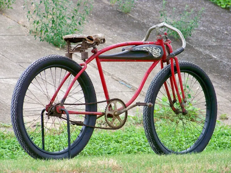

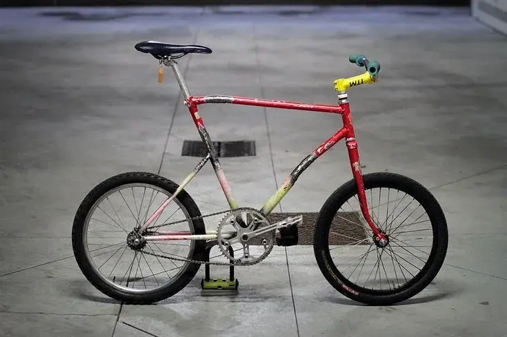

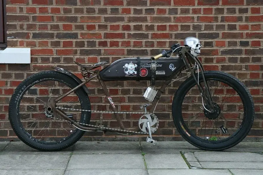

I like the first red one very much. Would be better and sleek without the "tank thingy whatever it is" and ½" off the tyre width.

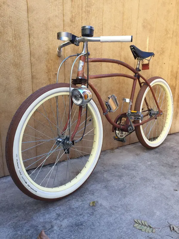

Here's what reallybigtim (recognize the garage door from #6?) is building now... 238600-build-off-finished-bike-1.jpg 238601-build-off-finished-bike-2.jpg
You mountain bike types may want to note the Stuart Warner floating hub up front, it's a torsion sprung suspension system in the hub itself, an Elgin option in the late 30s. Also interesting is the seat adjustment, no seatpost, so you just slide it back for more legroom.

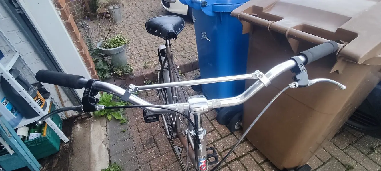

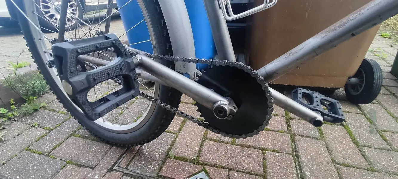

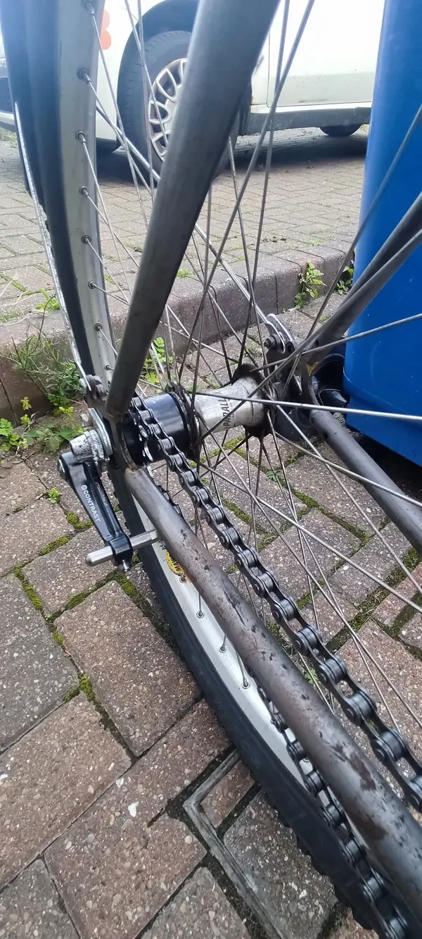

It's currently a 34 tooth front and 16 rear and it's too hard.
I've got a tiny 25 tooth BMX chainring and an 18 tooth rear. I'll try some mixing and matching tomorrow, but now I must eat and drink.

Ok, I've fitted the 18 tooth rear sprocket, the freehub seems to be a bit knackered, but carry on regardless. Had to remove the chain tensioner as it was fowling the freehub!
Took off the mud guards and off I went.
The gearing is better, but, the chain is tight then loose? As the cranks turn?
