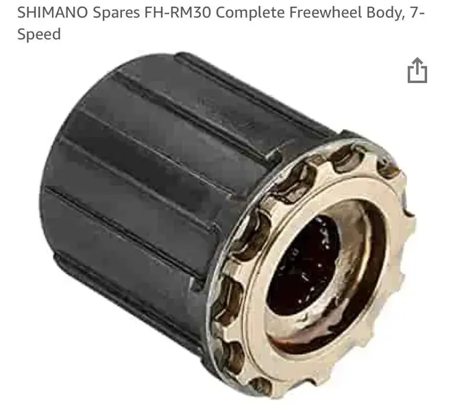

I bought a 7-speed HG freehub which fits perfectly. The base of the freehub has this fitting shown in the attached photo.
This is the section I got stuck on, because I don’t really understand how this freehub attaches to a wheel or what wheels would be compatible.

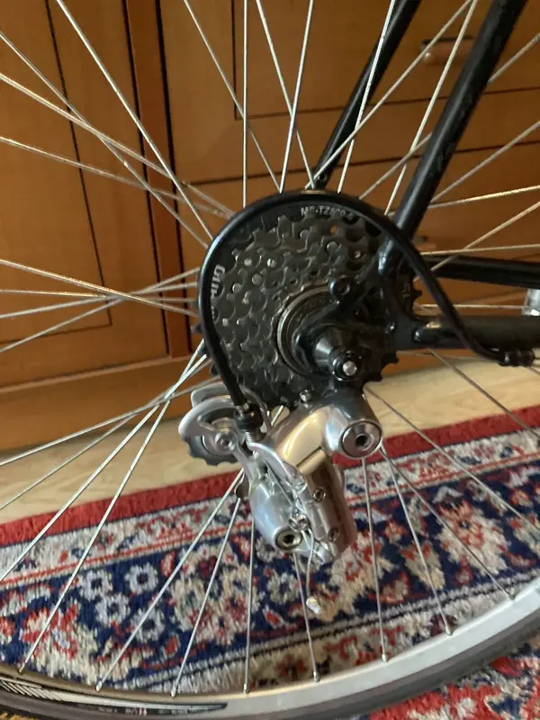

Your picture of the wheel shows a standard screw on freewheel type, not cassette
You can unscrew the old one with the correct tool and a big vice and replace it with a new one, anything from shimano or sunrace.

Basically, the wheels are bent and the freewheel is a 6-speed, which isn’t working well with my new rear derailleur (7-speed).
