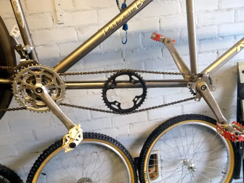

you need some sort of eccentric BB to get the chain tension right
Good work!
Some tandems just have a roller on an adjustable mount to keep chain tension, easy to fabricate and a lot cheaper than an EBB. Possibly not good enough for off road use though?
Chain tensioner
Yeah, I was thinking of making something similar with a jockey wheel under the chain on a pivoting arm so that I can attach a spring.
Sheldon suggested putting a floating bigger chain ring in the middle so I just set it up as pictured and snapped the sync chain within 200 yards!

I would give a half link chain a go they it would take some slack out and they are strong enough for bmx racing so should be less liable to snap.
on the tensioner front pashley trikes all come with a spring loaded tensioner arm that should be easy enough to source or copy.
I was going to suggest the floating chainring, but I'll keep quiet about that now :)
Some sort of BB-mounted roller guide on the front chainset?
