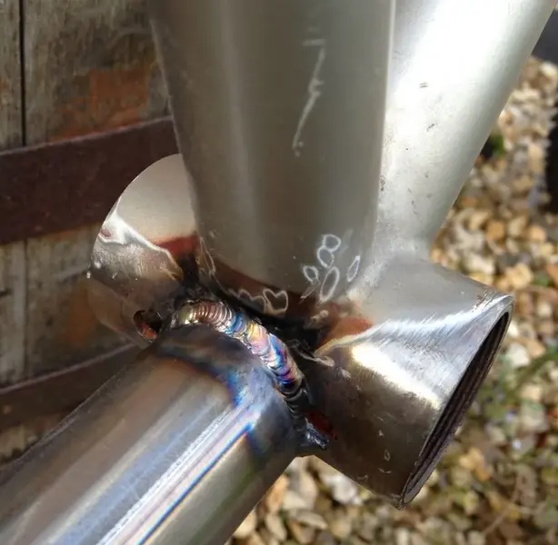

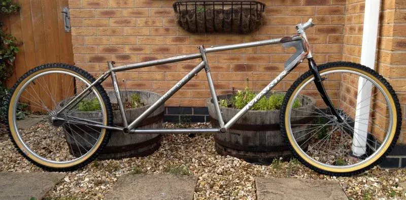

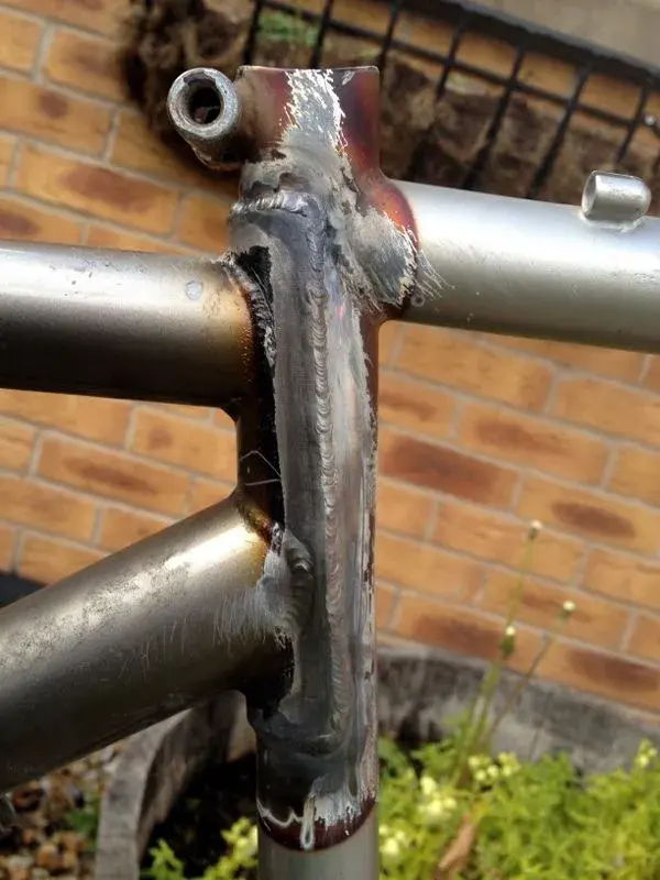

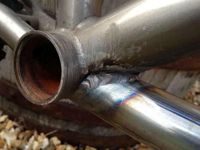

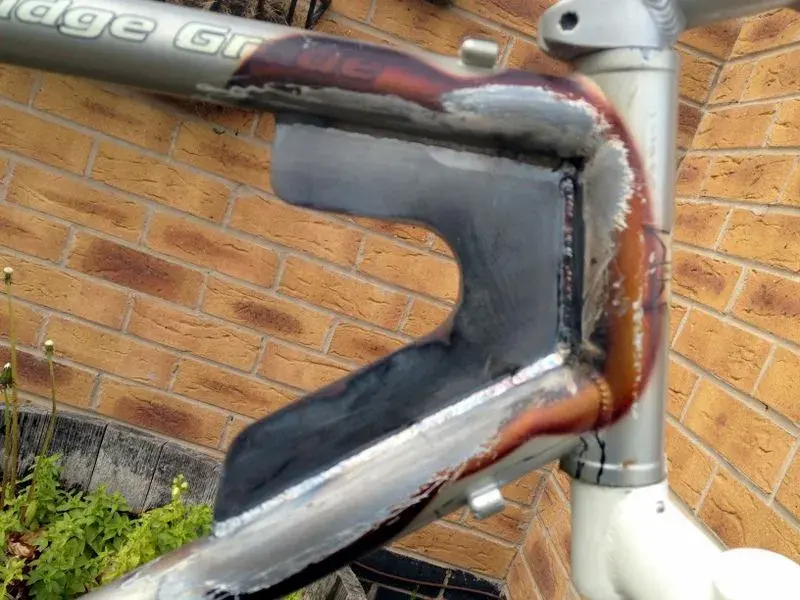

Frame has been welded!!!
Ok, it's been a long time coming but the frame has finally been welded by a mate's mate at work and he looks to have done a great job.
A quick mock up build and a few bounces on the boom bar suggest that it's pretty solid....

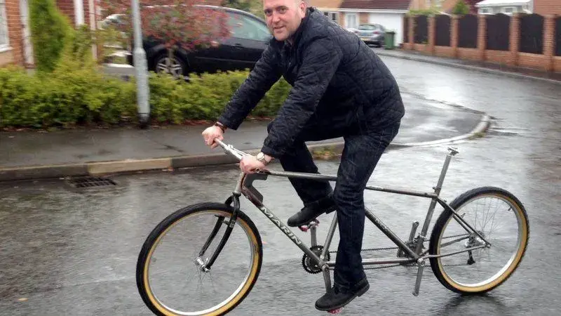

Test ride complete
Just taken it for it's first ride - 3.7 miles to the pub on the road and 3.2 miles back off road with a bit of dutch courage!
Neither of us stopped laughung for the entire trip. :lol:
Either way it was enough to convince us that we should strip the frame back and get some paint on it and some matching components.
If you ignore what we had in the garage to start with, it currently stands us at £26!
Our only issue is designing a chain tensioner for the sync chain which kept slipping a link and forced the cranks out of alignment.
We will stick with running the sync chain on the granny with 42 & 32 tooth outer rings I think but we'll replace the 22T inner with a 26 or 28.
Pedalling is much harder than we imagined - certainly not twice as easy.
The frame felt very stiff vertically but a little bit bendy bus in the bends.
Initial thoughts re the theme is army camo paint with brown finishing kit and military decals.
Any suggestions re the paint or the chain tensioner would be welcome.....
