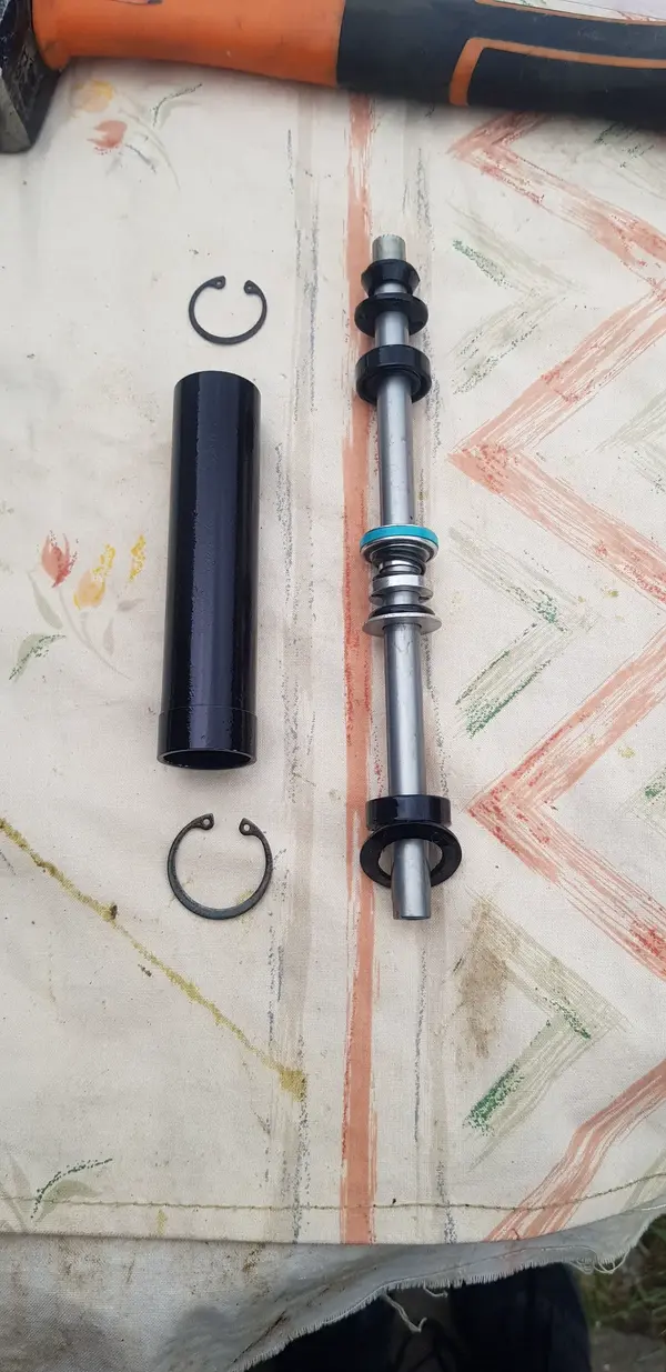

Help with this Rock Shox please
For completion, this is the open cartridge.
Would I need to fill it with oil completely?
Any tips on how to do it and avoid air getting in?

Yes, completely full of oil. I think it's a simple case of filling to the brim, slotting the seal in, excess will spill out leaving it topped. Iirc a circlip holds the seal in place. It's been a while.
