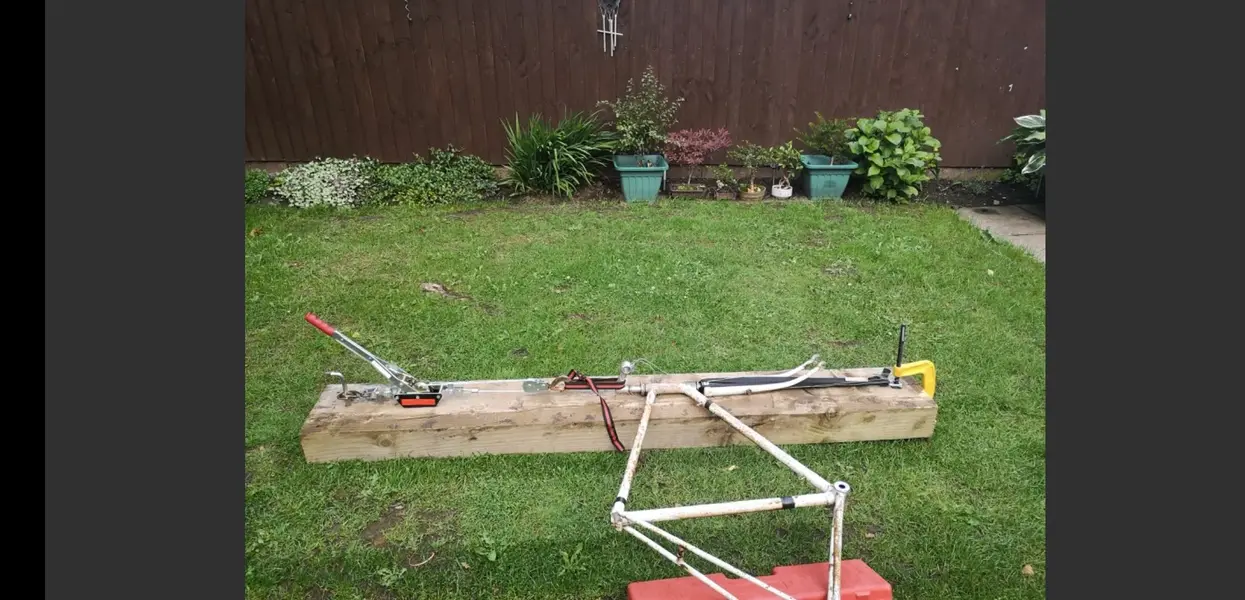

Well this was fun, finally got the stem out but its nackered. All bent and cracked so ordered another one, also fork stem is bent but I'll try to straighten it, still not ID it yet as been ill with tooth absys. Here are some pics for fun.

You're a brave man. I can see that setup resulting in a trip to A&E, so I hope you contracted the job out to an enemy.
Looks like those forks have been run over with a car - the gap between ends looks awfully narrow. I'm not a frame-builder but you may wish to take advice from one on how much you can bend the steel around before risking its structural integrity. I'd GUESS quite a bit for common or garden mild steel - the same is certainly not true for the fancy alloys.
Perhaps it would be wise to stick some new forks in?
Yeh I used a weighted blanket on top (special blanket with been bags sewn in for my autistic son) with some wood piled on, also thin steel cable through the hole in the forks and the stem as an arrestor incase it jumped out, finally I tensioned it to my biggest comfort level and stood to the side with a 6ft 2x2 to push the winch handle down lol. Yes a bit apprehensive I was.
Thanks for that link I'll go over it later, I need to have a close look and try see where the bend is coming from.
