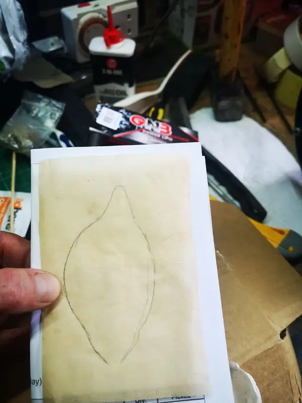

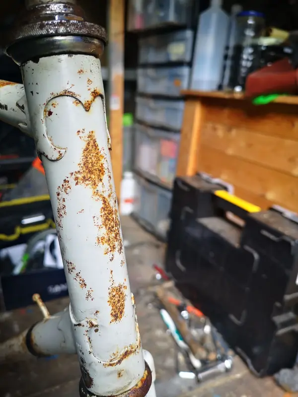

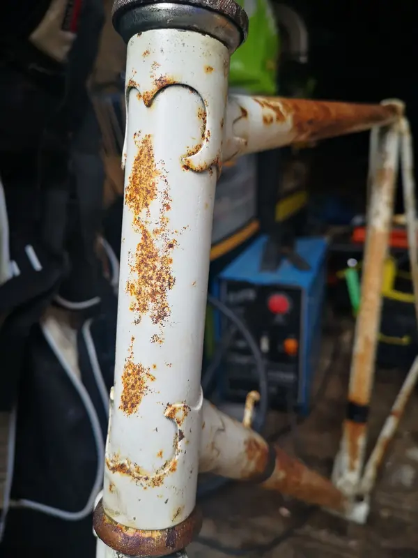

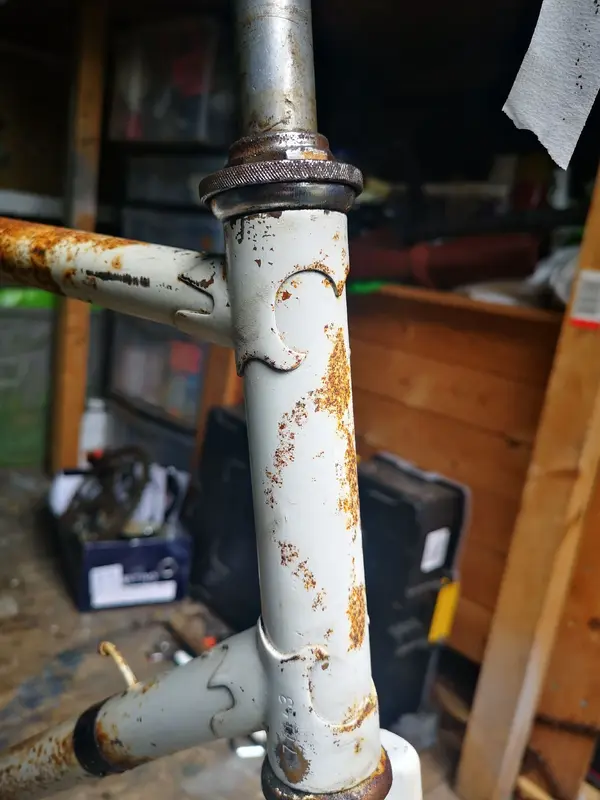

Well I have traced as good as I can what is left of the badge and took a few closer pics which I will paste below.

I found an old bike shop not too far from me and took it in for a bit of advice and a few replacement parts, while there the guy had a look at the frame but couldn't be sure what it was, he gave me the following names to look into which he thought it could be so at some point I am going to have a google of it and hopefully one of those may be a gold colour similar to this one.
Raleigh
Carlton
Falcon
Coventry eagle

Your local shop's advice seems sound. Looks maybe Falcon-shaped to me??
Only thing is that I'd expect there to have been a couple of holes for rivets.
This crowd do replica chrome plating kits and of course H Lloyds do decals - and actually they have a bunch of head badges on their site that you might be able to compare.
