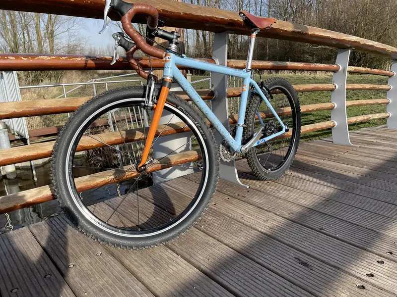

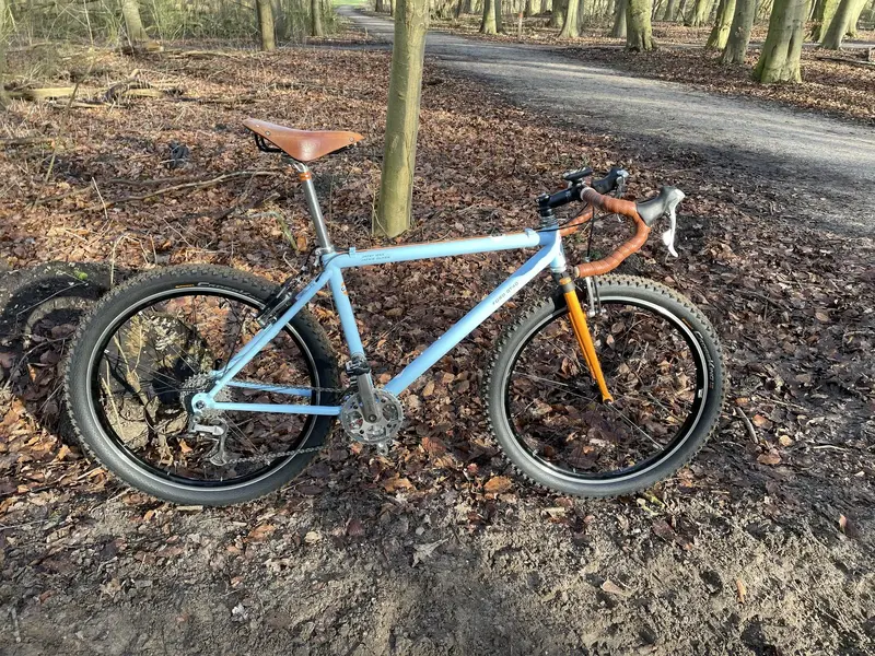

I’m in! Found this bike in a local pawn shop and didn’t know at first what it was, but with a Syncros stem and XTR canties you can’t go wrong. Plus the Gulf livery someone gave it. Now converted intro a drop bar with Dura Ace brifters and XT V’s. Recently added a small front rack. Rides like an old Trek 8500 because that’s what this frame is.
Loving the look of this. Being able to shorten the axle to crown on the forks and reduce the size of the gap between the tyre and down tube makes an old 26" mtb conversion look really good.
Do you know what make the forks are?
Mate thats a stunner. Nice and clean. Real monstercross. What size tyres? 2.3? Do you get much clearance?
