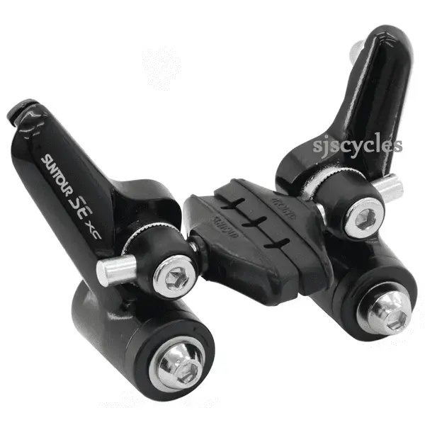

Mini-Vs aren't going to work, both the straddle wire and brake shoes are too low to fit those wheels. So definitely need cantis. Previous experience with these tiny frames where the rear triangle/seatstays are so shallow is that my heel would hit my Tektro canti on the rear as it sticks out quite a ways from the frame horizontally. So I've got a set of these to order which should be more flush with the frame and hopefully avoid the shoe interference (thanks @sunympholepsy for the thread which I stumbled upon looking for hangers!)
Another tiny frame, sloping top tube issue is the lack of space between seatpost clamp and wheel to fit the yoke and wire so I've opted for the tiny Raleigh hanger instead of the longer Tektro one.
I'm trying to predict what other bits I might need from SJS as they are so good for these parts and would be nice to get it all in one go rather than pay shipping each time. Maybe worth getting a bigger chainring now too while I'm looking as 42t probably won't do it.
I've just bought one of these from SJSC. https://www.sjscycles.co.uk/brakes/tektro-power-hanger-brake-enhancer-for-cantilever-brakes/. Not fitted it yet but could it help address the space issue?
