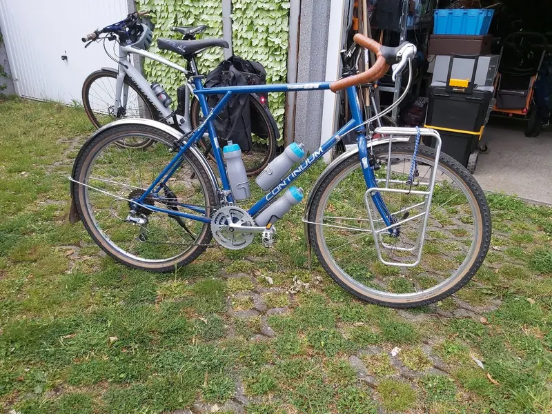

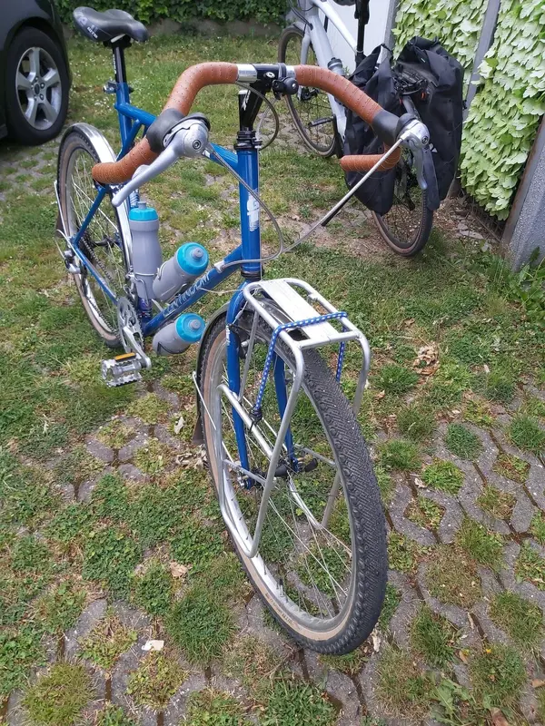

There are a couple of things I'm struggling with, one is using a compact double 34/48 - it just feels all wrong compared to a trusty triple and the other is getting the postion of the shifters optimal. The shifters are dura ace bar end shifters mounted as thumbies but in certain gears they are taking up hand grip space.
The final tweaks eh! I ended up fitting downtube shifters on a frame that never had them! So nice having uncluttered bars... snd a road chainset 39 52 🤣 but I live on a marsh so it's all road to get to anywhere near off road and then we'll it's still flat!
Looks great that DY! Same tyres I’m running on my gravel thing. I really like them as long as they are tubeless.
I ditched the compact triple and bought an ultra low double from Spa Cycles. It’s a triple with the largest ring removed. Running 26/42 with 11-34 8 speeed on back. Still not a low enough gear so now looking at an 11-40 on the back.
I'd suggest a 48x34 is too big. I'm running a 46x30 on my purpose built gravel bike and that's even a bit too much when it gets really steep. No shame in running a 3x though although I'd look for a microdrive crank.

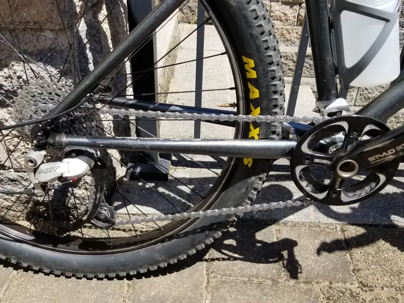

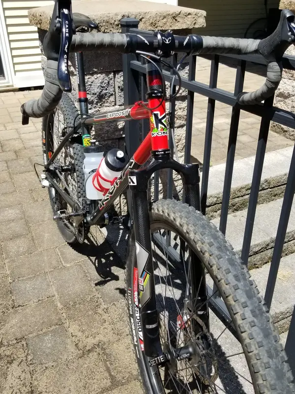

My 16" 1999 Kona Explosif 1x9 setup, b6er, bar end shifter, carbon fork

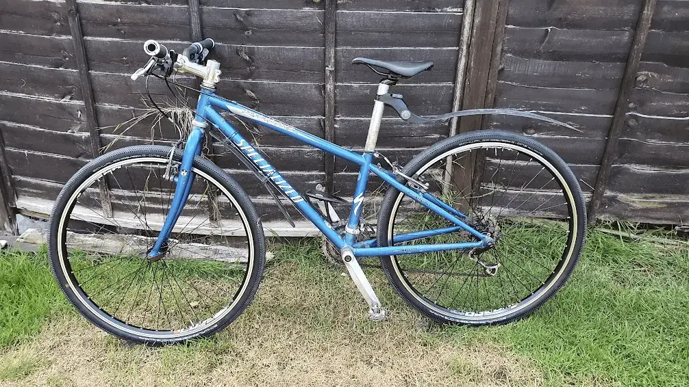

Update: found a 1999 Rockhopper in the same size, much cheaper and close to home. Bit rusty but a good start -- if I love it, I will look to upgrade the frameset at a later date. Came with a 9 speed LX rapid fire, but 8 speed cassette and chain.
Anyway I have fitted it with 650b wheels and 38mm Schwalbe Allrounds, so far so good. Now looking at swapping to some drop bars from a kids' 26" CX bike I have, along with the cheapie 2x8 Claris groupset on that. Presumably I don't need to change the mechs as they will work with the shifters? But will need to swap to mini-Vs or cantis -- I think the former will just fit with those bigger wheels so I don't need to fit canti hangers (I hope!)
What to do about the square taper triple chainset, will the Claris 2x front STI work with the 32/42 chainrings if I trim the mech screws? In the long term I would like to go with a 1x set up with shorter crankarms but in the meantime I just want to keep everything pretty cheap with quickly and easily acquired parts whilst I play around with what works, what I like etc.
Yeah the seatpost height surprised me, I think I'll be looking for a longer one as I'm definitely pushing the limits of the minimum insert there... however the toptube is just barely short enough so I guess long term I'm going to want a much earlier model than 1999 to keep the reach short and the toptube less sloping?
