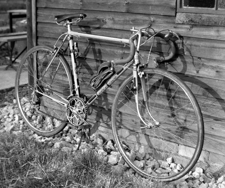

That is unusual. Even more so with the ball-ended Cyclo bar end levers on the South of France style bars, seen here with the left lever operating the rear changer, so 'wrong' way round.
What frame is it? Can't quite make out the lettering but it looks like Leo Vince. Not a make that I know of.
It's a wonderfully evocative picture.
We always regarded Gillott as a very top class frame, but this one was obviously built for a road racer which meant BLRC (as I was) not NCU.
Picture above in 1952 is my Les Vince, Walcot St Bath, cast lugs etc. The front changer is in Brown Brothers 1952 Catalogue page 55, and came with handlebar control. No double down tube levers then. Note that to make them work the cables had to be loose not taped into the handlbar.
The rear hub was a rare Harden freewheel hub, with Cyclo 5 speed cogs made for freeewheel hubs.
The 5 cogs and 2 chainrings would give 10 evenly spaced gears, but to get the next close ratio would alternately need to change both front and rear. So you see why handlebar controls were used. Try changing both at once with frozen hands on a double downtube lever.
"South of France" bars were a lot smaller, nothing like the bars used by Rene Vietto and Apo Lazarides.

Keith, I also encourage your recollections. In this case, the Cyclo catalogue (p14) has the shift cables being taped under a section of the handlebar tape where your bike no doubt reflects what actually worked better.
And pleased to see the full bike, and not just a section
and how did the Pennine pump lever not get lost? It looks like it is unrestrained.
It would be so informative for you to take that one photo, and start a thread and talking through each component, what worked, what didn't, why it was chosen.
Re: 1954 AS Gillott Frame?
Yes, the Cyclo bar end levers do work okay with the cable taped underneath the bar tape. I have one on the left side of the handlebars on a Bates, operating a Simplex front changer (downward pull) as it only has a braze-on for one down tube gear lever, but the action is quite heavy, so I am sure it would work better had it been outside the bar tape, as on Keith's bike.

I was also running a Benelux rear gear which would not reach the low gear particularly in the wet if there was any resistance in the cable. Bear in mind 1n 1950 I covered about 15000 miles in all weathers.
It all had to be practical rather than purely for appearance.
Keith

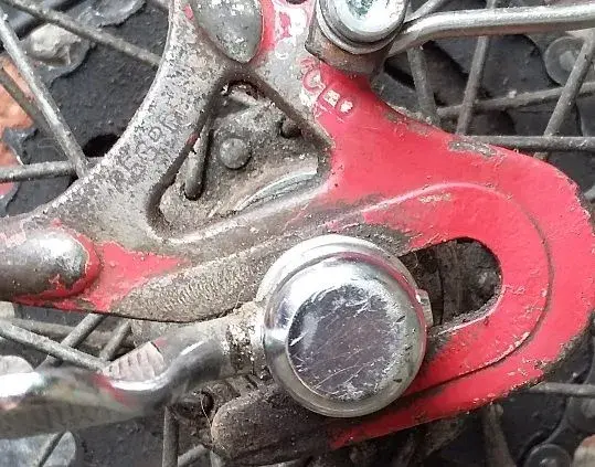

Rear Dropouts images...
