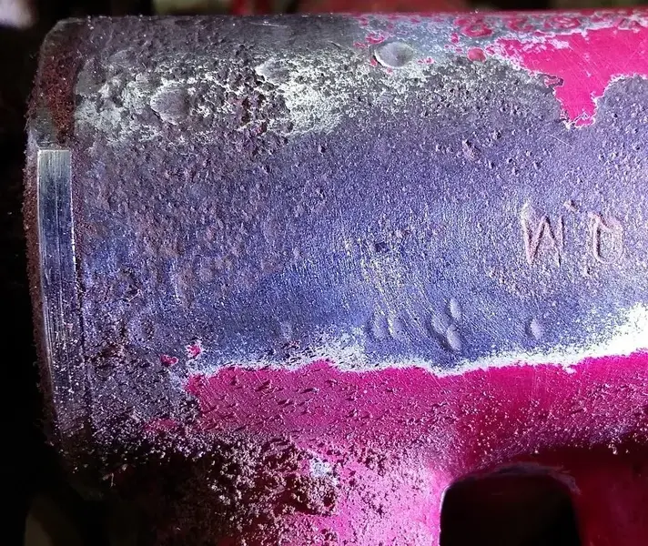

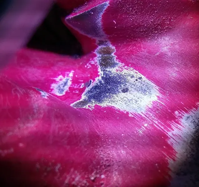

If there's a centre punch mark on the BB shell between the chainstays, Ron Cooper built it.
Hi Roger,
Had a look at the BB shell and did some light sanding to see what I could find over and above already posted...
There is a centre punch mark where you advised (arrowed). In addition there are some strange markings above it (circled).
It took a set of Jeweler's magnifying glasses and some emery paper to be absolutely sure of the centre punch. Didn't see it at first until after I had started rubbing...It's definitely a Centre-Punch mark.
The strange markings above look like some form of numbering stamps? 1-3-2-1. Man made, for sure.

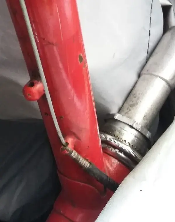

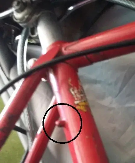

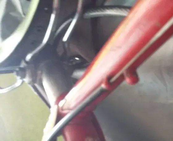

Here are the images of the mysterious Cable Stops...on the top tube and the seat tube:
1. Cable stop on Seat Tube:
2. Cable stops on front and rear of the Top tube.

It is indeed a 1954 Gillott. The lugs are Spear pattern and unique to this model. I have a similar one made in 1952.
Didn't know about the centre punch dot for Cooper built frames, but it doesn't really matter who built it, as all Gillotts of that era are superbly built. Boss Harry Carrington wouldn't allow anything out the door that wasn't top quality.
Extra cable stop, not SA, it is on the seat tube. This would be Cyclo front changer, probably with Cyclo handlebar control, throuigh additional stops under the top tube.
The rear brake cable is in the wrong cable stops.
Keith
Re: 54 Gillott
Keith is right re the cable stops. I think a Simplex or Huret helically operated mech might be more likely. I've asked Sand Dune for pics of the rear dropouts to see if there is a Simplex hanger still there. So many got cut off though. The frame is a genuine Ron Cooper built Gillott. It had the boss cut off its Simplex/ Huret/Cyclo gear control and may have lost its pump pegs too. Only a scrape at the paint on the likely spots will tell.
