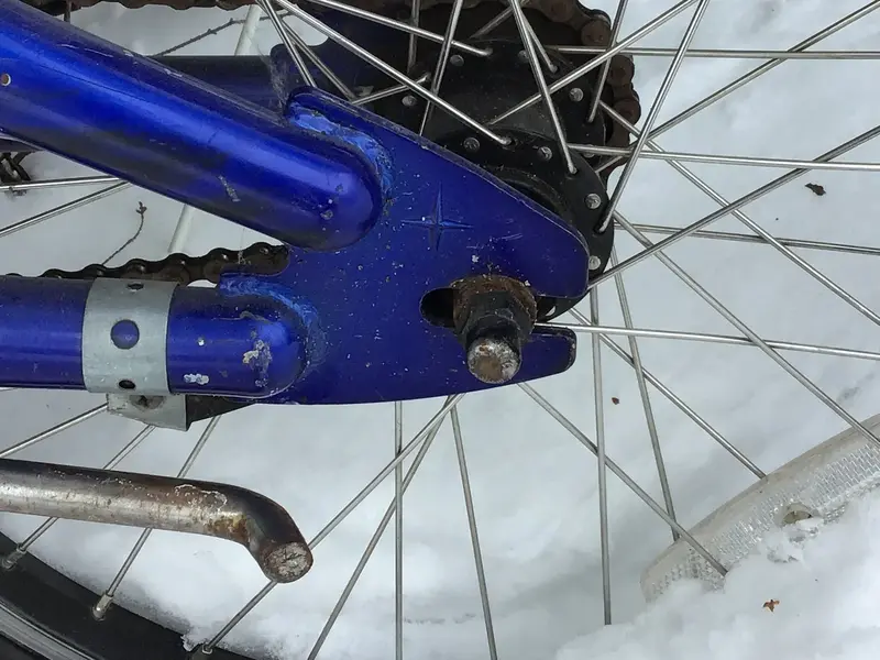

I bought a kids bike with 20 inch wheels for $5 that will donate the grips and track style rear fork ends. BB3A6E4E-76DA-47CA-9656-D76CBD1F791C.jpeg 8935F4BD-09ED-424B-B29C-6EC600342A32.jpeg

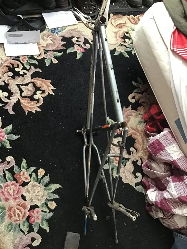

I also bought a 1980s big box bike for $20 that was posing as a mountain bike. It will donate derailleurs, thumb shifters, fork and steel rims. The original Breezers had steel Araya rims and stopped so poorly, especially when they got wet, that most people converted to Ukai or Araya alloy hoops. I’ll have to mount cantilever brake bosses and spread the fork about 6 mm. I have some hubs that sort of resemble the original Phil Wood units. I plan to re lace the steel hoops with the quasi psudo faux imitation Phil units. C5B6A40C-8C52-439B-98E1-E4FF73B688B1.jpeg 4D89DD96-30FE-474F-9C56-B57AE40429DC.jpeg

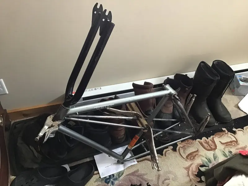

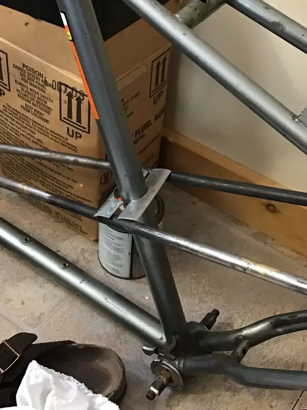

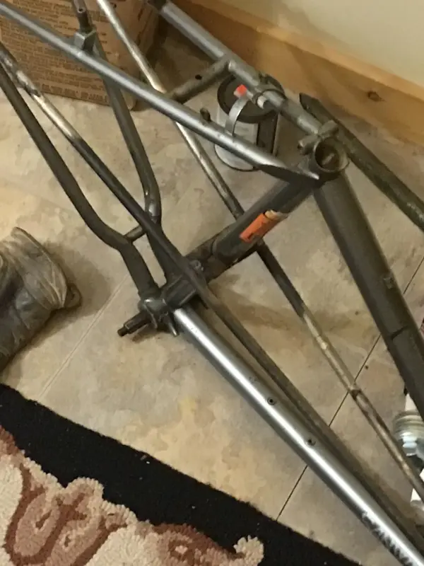

Laterals are tacked at the head tube. The drops and laterals will be temporarily bolted in place so that track drops can be welded over the new drops.

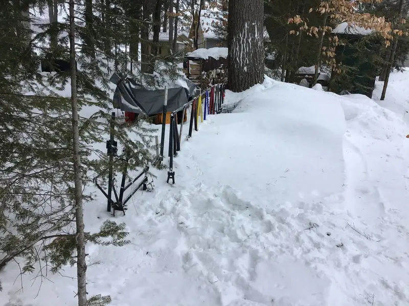

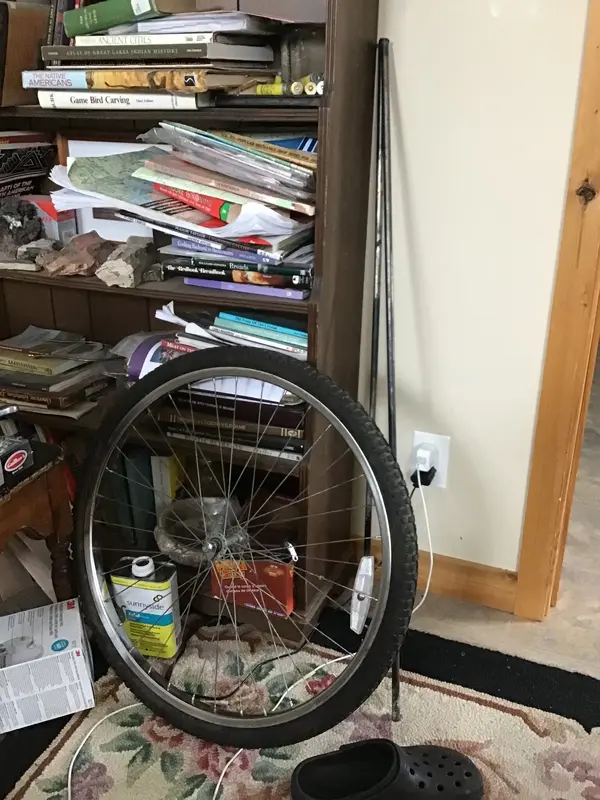

Steel wheel build in progress, trying to make the ride experipence as original as possible. image.jpg

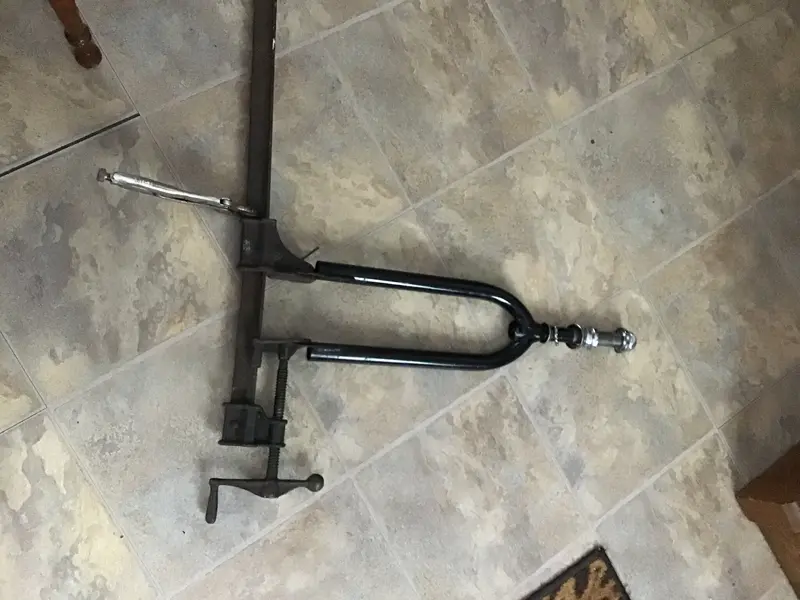

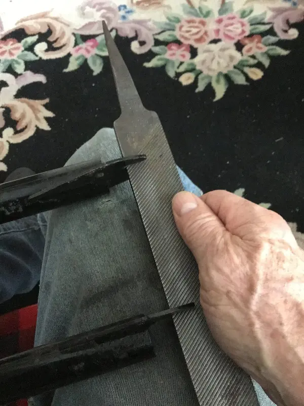

The fork drops needed to be widened to accommodate the new hub axle. I went from just under the original 6mm to 7.5mm. I don’t do the usual method of filing the new axles so they have flat spots so they fit the old drops. I file only on the back side of the drops, so one side is always original. I file 100 times with the weight in the middle, flip the file and repeat until it fits. I use a round file close to 8mm and a small 1/4 round to take the step out and make the bottom of the new widened drops so the wheel remains straight. This is slow going as the drops are very hard. 014DBC92-CF56-491C-99EA-A62F67EAC67B.jpeg 23357D6D-F94D-4B08-862E-CF91D709F8DC.jpeg

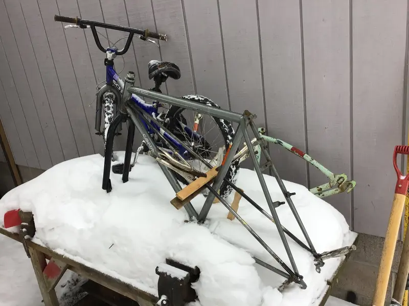

The rear freewheel will have to be removed by the bike shop. I tried to remove it myself and the puller snapped in two. It was too cold outside, -14C, and I think that’s why it broke. I had to shovel snow off my work bench to get at my vice, too much aggravation so the bike shop gets a go at it. When it’s off I can use the steel rim to build a new wheel.
