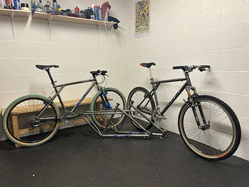

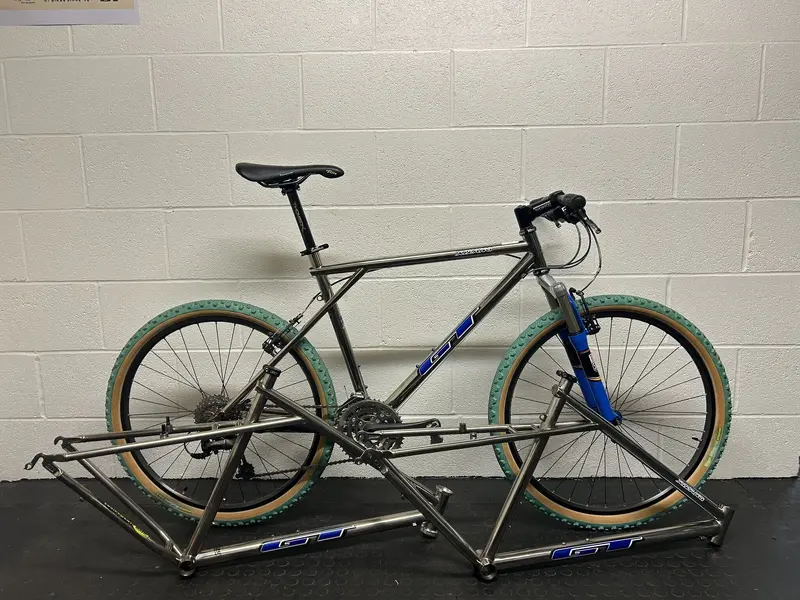

To continue this and compare further. I know the pictured Xizang is definitely 97 due to serial number. It also matches in every way to my fully built Xizang which is also 97

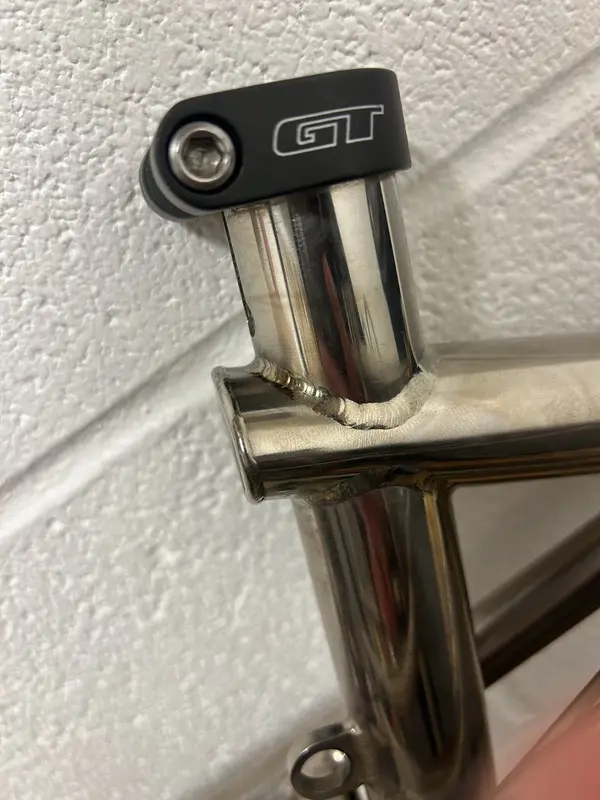

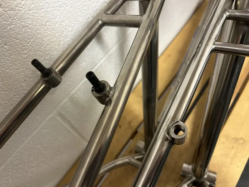

This other frame I have below , has 97 decals which I believe are original. It is a G serial but is a later frame (so maybe 96-98). But has many differences to the confirmed 97 frames.
The brake bosses on this one are a normal style

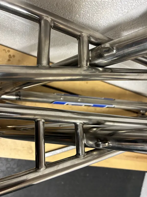

The braces which run between seat stays and chain stays are much thicker (around 3mm more)

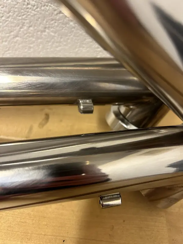

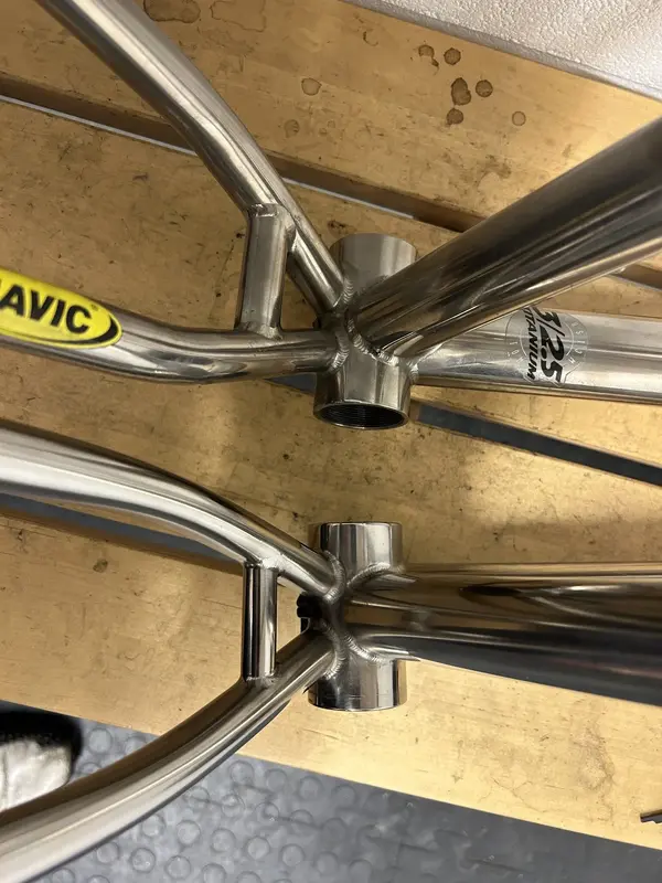

Also the end cap sticks out further much more like GTs tend to do (apart from Psyclone)

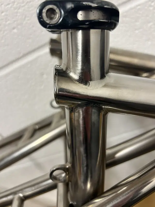

Also the cable routing is slightly different
This 3rd frame must be at least 96 due ti having the loop for canti. But has the made in USA stamp and G serial same as earlier frames. I’d guess it’s a 95/96 built but actually was sold in 97.
The GT cable routing is always interesting. Does a bit of housing liner tube just hang through the ring after wrapping around the seat tube? Or is it that extra thick tubing they used?
There was a question about that arrangement on another forum and I had thought it was a bodge, but was apparently the stock setup.
No you could get a small bolt on piece that held the cable so you can use a Canti. . I’ve never seen one for sale.
