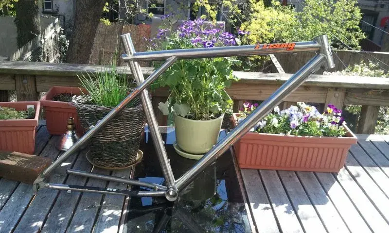

Serial Number- G18421 MADE IN USA
Seatpost - Shimmed, feels good with a 27.2 but will check with a micrometer
Headtube - straight gauge inside collars outside top and bottom
Rear Brake Hanger - Canti brake
Rear Dropouts - No logo
Cable routing - External
Stickers - orange "competition series" on the seat stays and "xizang" on the top tube, who knows if they're original

stauqmuk":38faj7y2 said:
Just accepted delivery of mine last night and I cant wait to get her built up!
Rear Brake Hanger - U brake
Hi nice frame mate looks like cantilever lever brakes 8) also maybe 1994 0r 95 year frame
