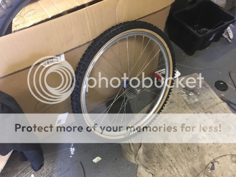

Panaracer smoke onto the rear wheel and XT M737 cassette nicely cleaned up and installed.

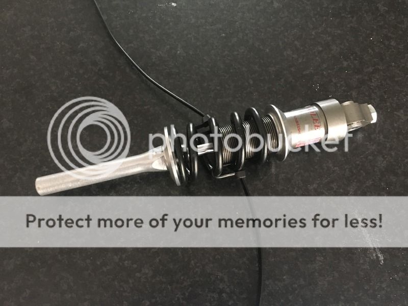

Then onto the shock. Cleaned up nicely (I dismantled it, degreased, wiped down, regreased the adjuster thread, polished the metal bits a touch then back together (note the zip tie spring compressors).

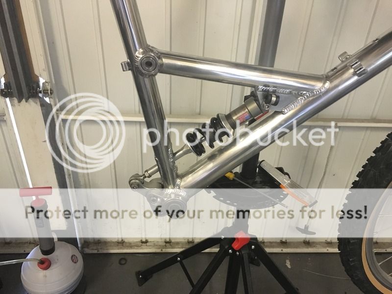

Then, installed. Top end was a doddle (cleaned the P clips up and noticed that some kind soul had already used stainless bolts everywhere). Bottom end was a bit of a faff. New rod end and it was a tight squeeze getting it into the rocker but ok. Then noticed it's too bulky so won't sit down low enough in the rocker to let me get the bolt through. Some work with my bench grinder sorted that out and now it's in nicely. Obviously I'll need to do a proper set up once it is all back together, I have the specs somewhere for all the measurements.
Final bit of progress for today was more polishing of the back end. Am onto the final stage now for the seat stay part. Should finish that tomorrow and hopefully the chainstays too. With that done and the wheel in it'll be a recognisable bike again! On the seat stay, the mechanism for cantis is still there. That's nice for originality but annoyingly the circlips that hold it on are too small for my circlip pliers and ideally I'd like it off just for cleanliness sake. Will have to have a think.

Anyway, progress is: rear end finished polishing and installed, rear end set up as much as poss while unladed, both mechs cleaned up, rear mech fitted, rear brake cleaned (although like the front I need to paint the booster - and I will also replace all the bolts on them) and fitted.
Rear brake still a faff but easier than the front. The hose is too long on it as well so both of them will get a trim once I have done some more.
